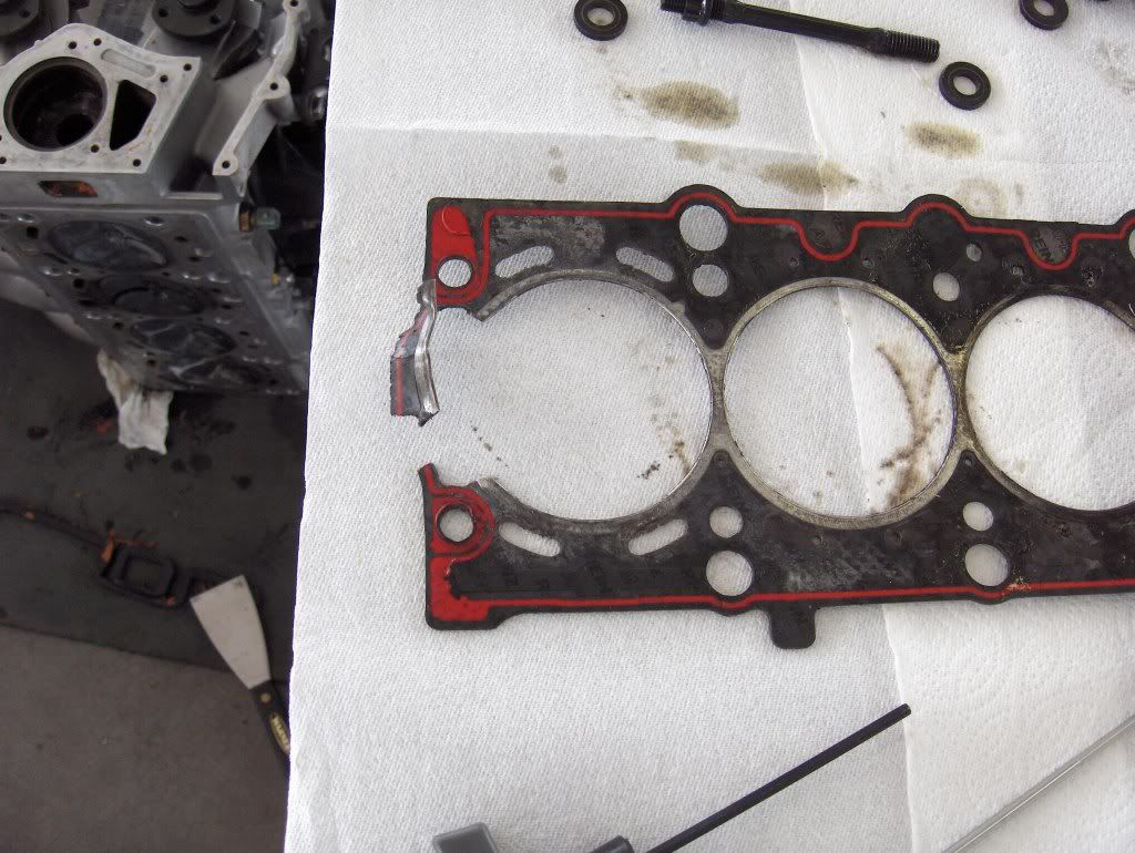

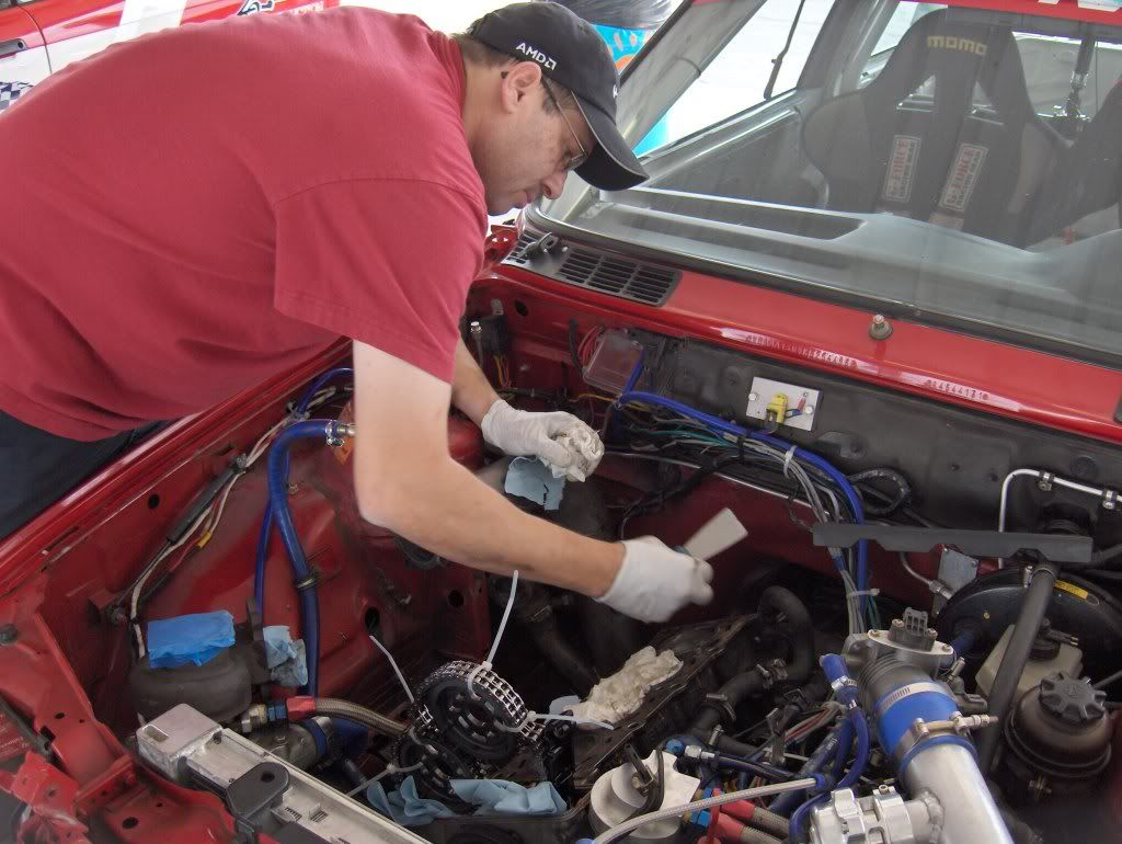

    We had a challenging weekend. It started when we blew a head gasket after pulling on to the track for the first practice session on Saturday.

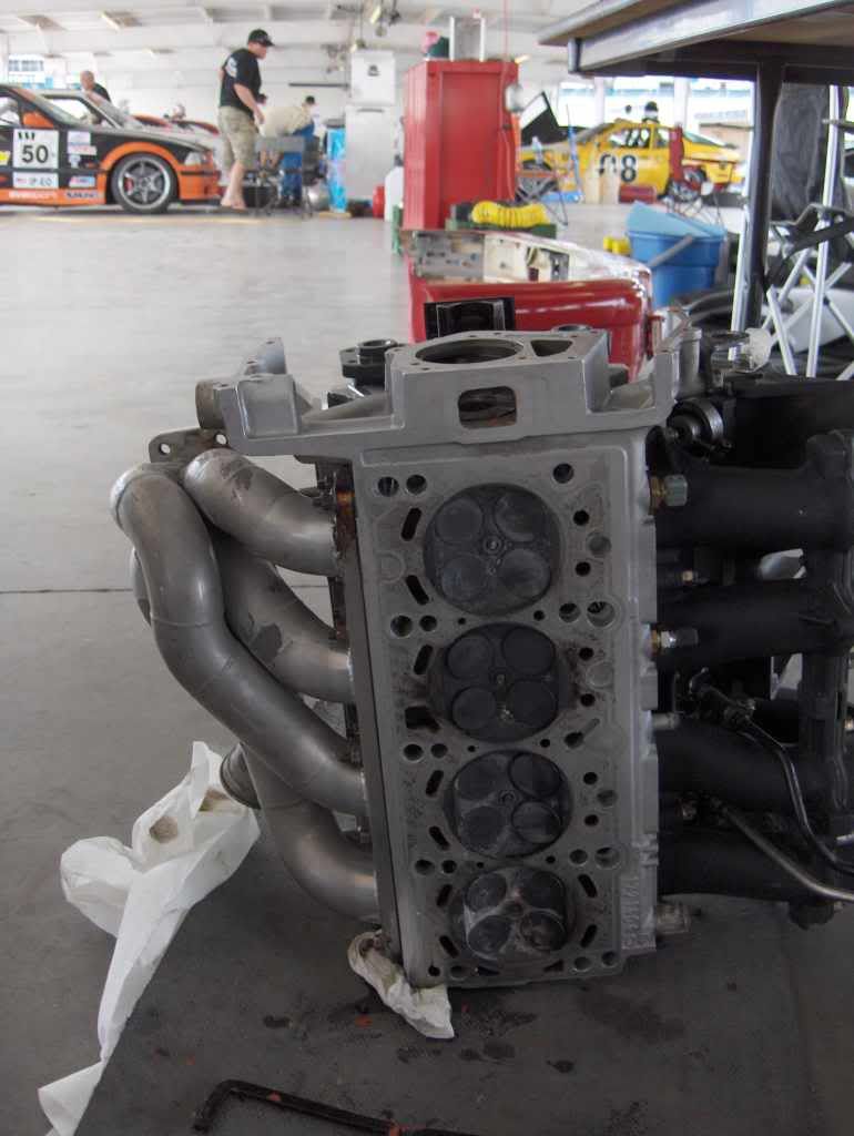

    Our welding guy had done some work on our exhaust manifold. He ended up taking some stuff apart to get the welding done. We checked his work but missed the fact that he hooked the wastegate up wrong.
    We managed to replace the head gasket in about 5 hours in time to make the Saturday race.

          Like I said, we put the car on the track on Sat for the first practice session (8:20am) and we blew the head gasket. Its a long story but someone swapped the hoses on the waste gate. We think it was our welder. At 9:45am we started the head gasket job. We completed the job in time for the 3:30pm race.

                      So did the head not warp at all when the gasket blew? It seems like every time someone blows a gasket on a turbo M20 the head needs to be sent to the shop to be resurfaced.

                          No, since the blown head gasket was due to a sudden over boost instead of a heat issue there was no damage to the head.
