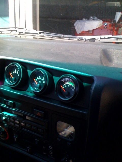

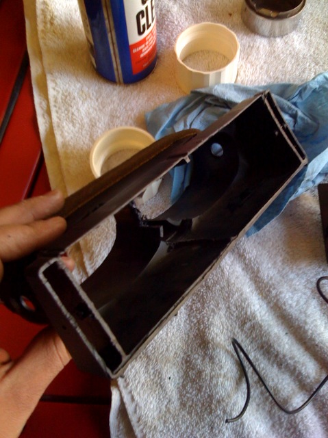

Yea, it is. I took a spare vent that I grabbed from the junkyard. I took some 2" PVC pipe (just so happens that a normal sized gauge fits in it perfectly) and hot glued them in place. Then I just FG'd over them and then cleaned up the holes to get a good, tight fit. Only thing needed to retain the full air flow from the vent is to block off half of the vent feed behind the vent itself so that all the air goes through the passenger side instead of blowing behind the gauges.My 2.9L Build!

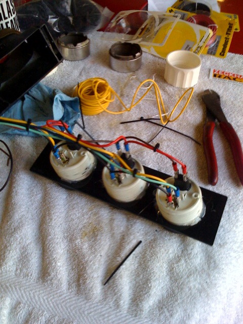

The base plastic is the stuff that stereo installers use. I cut out a piece that fit the space where the ash tray was.
I used some scrap plastic strengthen and provide support structure underneath the gauges.
The angled rings are sold by Autometer.Comment

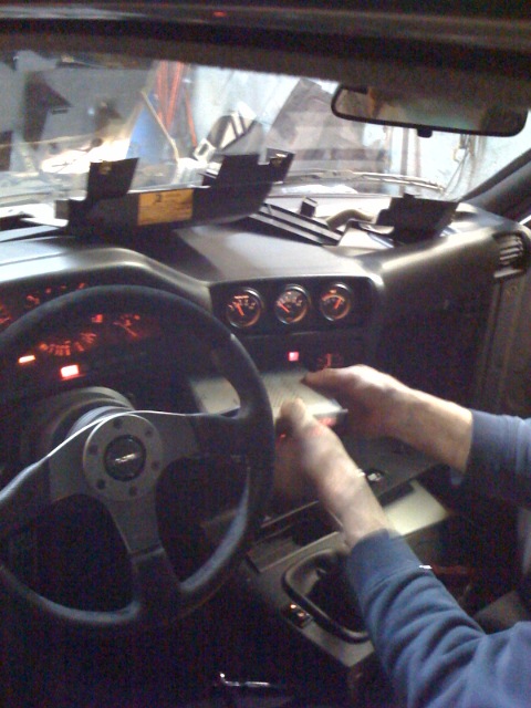

BUT, it did let me see that that was nto an ideal location, and that I really like the vent mount option the best in terms of line of sight. So no wI'm looking for best price on a new or used three gauge pod to go in the cetner vent hole.
