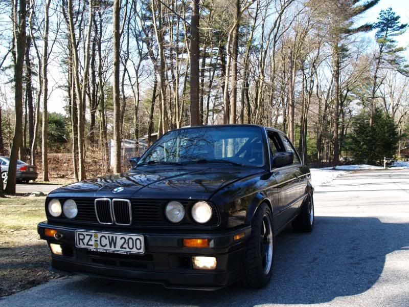

    Got the tires mounted and balanced (225/50/16 on 16x8 rota slipstreams). I am currently building an exhaust for the e30 but I mounted one wheel on the rears and it looks like it will juuust clear the fender... Ill probably be rolling and flaring the fender just a bit too. I will report back on on friday at the latest on the fitment.

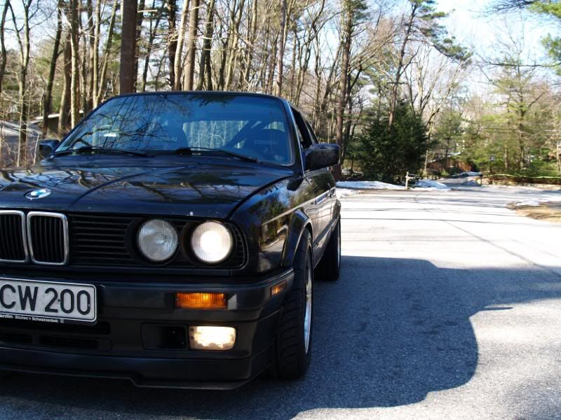

      With a modest fender roll... i get a little bit of rub at full lock

                205/55-16 on 16x6.5 wheels
                they are 24.9" dia, a little oversize like i said earlier. They definitely look burly.. and actually they are too close for comfort on the fenders. The wheels spacers need to be taken down a good 1/4" or so. They hit the rear fenders, and the fronts are extremely close to touching the front of the wheel well (valence+bumper) when I turn.
                Last night I banged out the rear fenders and dialed up the ride height.. will probly need to rent a roller.
