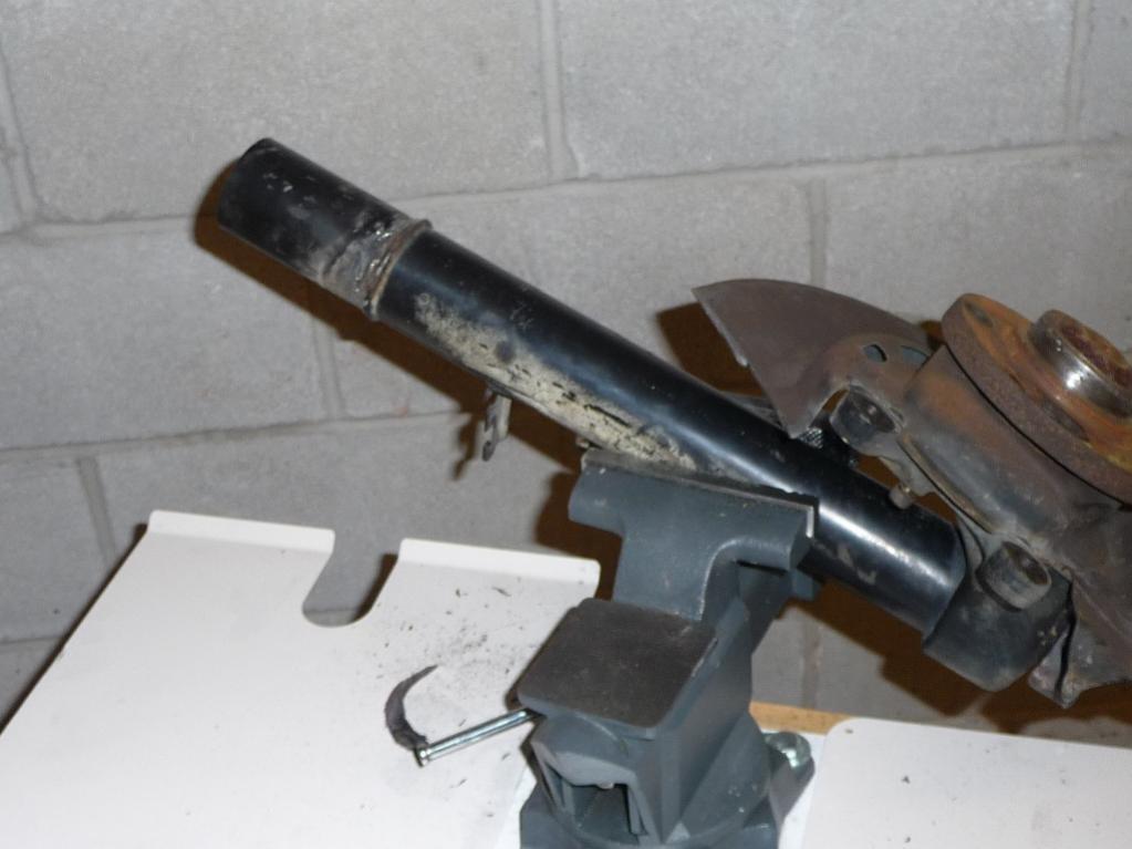

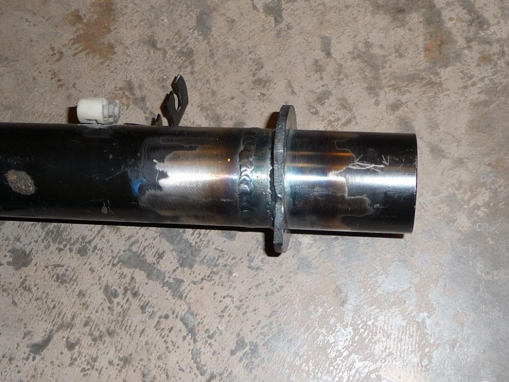

                        I don't have them on yet, as I've spent lots of time preparing to get them on. The attached pictures are what I was up to last weekend, and I just got all new elastic stopnuts for pretty much all the connection points for the suspension to the chassis, knuckle, etc etc.
                        I'll post some when I get it all together.
