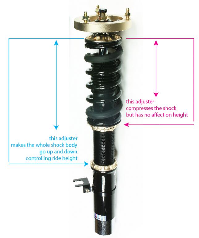

          Quick question, guys. How do I adjust the rear preload on BC coils? I've messed mine up and can't seem to figure it out.

            #70565
            e30 rears don't have preload, just ride height adjustable. Unless you've switched to a rear coil that is on the shock.

              #70566
              They most certainly do have preload. I adjusted the shock height which completely messed up the ride quality. The preload's on the spring.

                #70567
                I'm not following what you're saying. From my use of coilovers e30's aren't set up for spring preload in the rear unless there are 2 sleeves.
                is your spring on the shock body or wedged between the frame and trailing arm?
                if it's on the shock body than just crank the spring perch upwards.
                if it's on the trailing arm you can't adjust preload, that's just ride height adjust.

                    #70569
                    Then what's the difference between the adjuster on the shock and the adjusters on the spring? And why did my ride quality go completely to shit when I shortened the shock a little?

                      #70570
                      not all coilovers are the same. Ground Control setup doesn't really accommodate for preload while other brands like BC does give that adjustment. The jury is still out on whether that all makes that much of a difference from a street perspective, a race car driver might be able to feel the minute differences but the average joe wouldn't know.
                      this is an example of preload adjustment on a bc front coil:
                      the rear does not have a second sleeve to control the compression of the rear so there is no preload on our oprhaned spring set up.
                      what coilovers are you running?
                      when you shorten the shock length you are losing shock travel. less travel means less comfort in it's simplest form.

                        #70571
                        Thanks for the detailed post! I'm running BC's on mine. I searched around google a bit and found a video BC made on preload adjustment for cars that have independent rear suspension. The video said to unbolt the shock at the bottom, lower the spring as much as possible, then jack up the control arm to a desired height and adjust the spring to that height and finally lower or raise the shock to that chosen height. Apparently that's how you set the preload. But now I'm confused since 2 people are saying these cars don't have preload in the rear.

                          #70572
                          my opinion tells me that the technique described by BC doesn't apply to oprhaned spring/shock combos but a shorter shock does in theory affect ride height so there may be some truth to that. try their suggestion, worst case you go back. I definitely would not call this preload on our setup though.

                            #70573

                            Yeah I'll try it out tonight, hopefully it works. Getting tired of every small bump causing the car to bounce or harshly shake. One more thing, what do you mean when you say "orphaned spring/shock combo?" Never heard that term before.

                              #70574
                              spring & shock coilover = one unit, like a macpherson strut
                              orphaned = spring one place, shock in another
                              e30, lots of volkswagens, some older mercedes have orphaned set ups.

                                #70575
                                spring/shock coilover = one unit, like a macpherson strut
                                Ah I see. The BC video was for the orphaned setup (independent rear).
