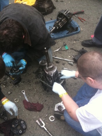

          No, we were the Gay Tank with the penis for the canon.
          Pic is of James and Alexei trying to figure out WTF we were doing.
          We swapped a good selector fork from our E tranny into the I tranny and then put the E bell-housing on it. In six hours under an EZ-Up, we were able to diagnose, repair, and install our hybrid-tranny. Not bad for a group who have never really worked on a transmission haha. We'll be keeping it as a spare.
