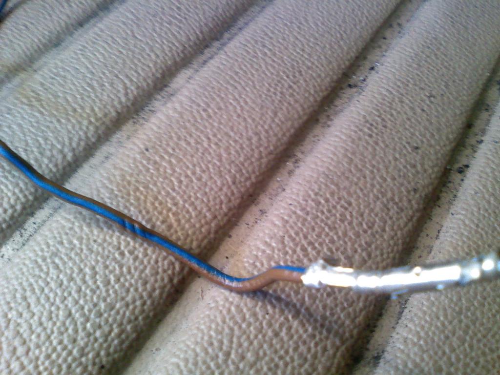

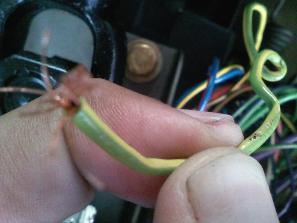

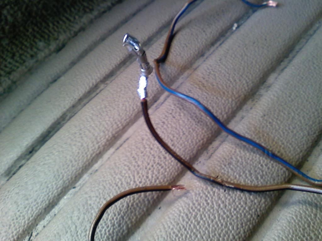

        Here are the photos:
        -green/yellow wire: torn
        -blue/brown: torn off
        -black/brown: torn off
        that's all I can see at the moment.

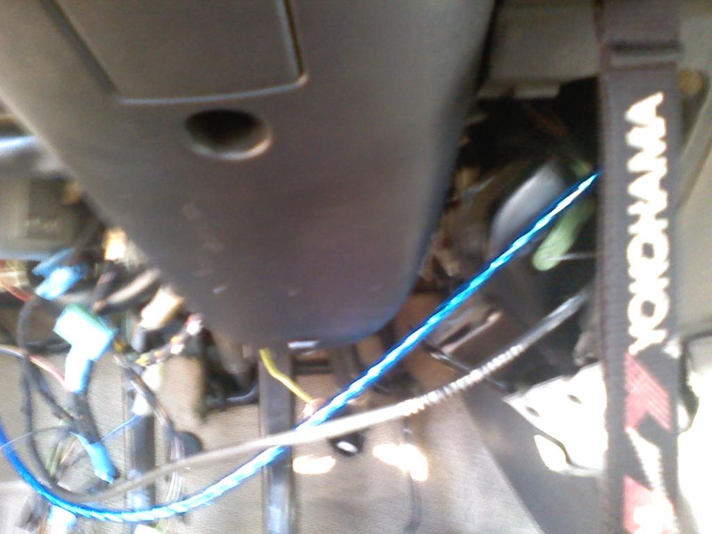

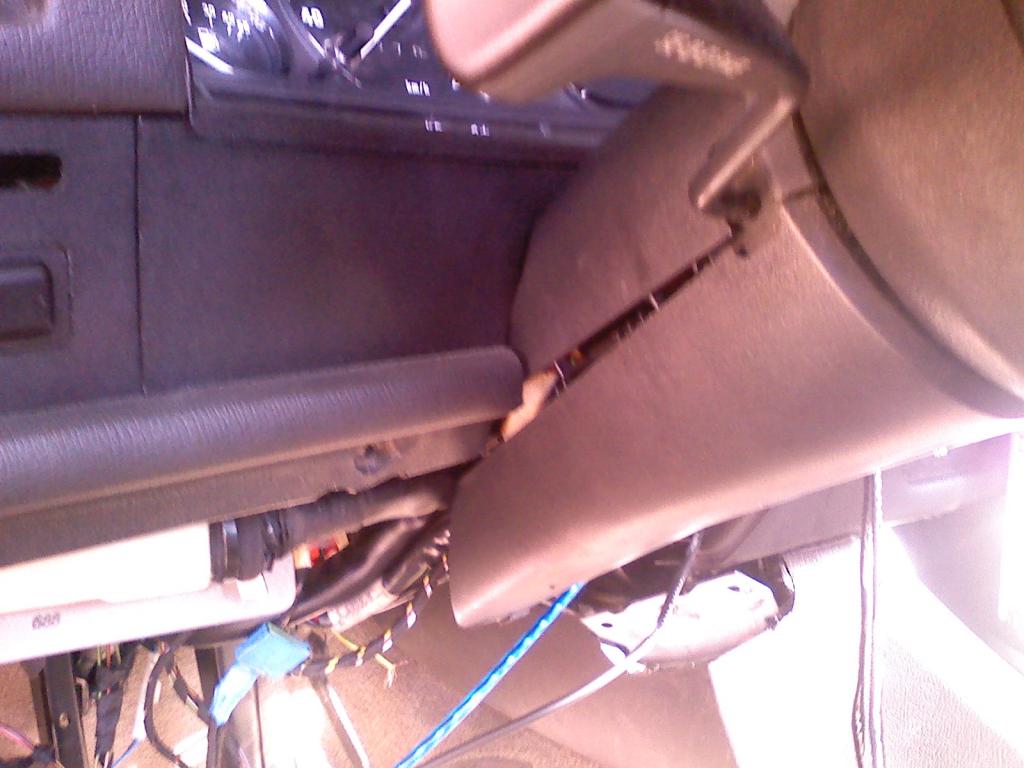

        also, for some reason, even when I tighten the screw under the steering column cover, the cover won't close up the gap all the way, there's that gap between the top and bottom.. :???:

          Looks like some ground wires for the turn signal stalk or ignition breh
            doesn't look too hard. i would disconnect the battery first. check fuse, replace the one that is blown. take out the dash if you have to. reconnect wires where they broke off from. Gl

              Do you guys think that one could re-solder the wires and just plug them back into the connectors?

                take the steering column cover off and take photos. is it connected to the ignition switch?

                  Bernz, me and my dad are looking at that right now.
                  How do I get it off? I removed one philips screw, but its still holding on..
                  Then i took that little plastic slot off, and I saw that there's an orange/yellow plug there...for SRS?

                    posting the wire colors doesnt help us much, we are not going to spend an hour looking through diagrams to find that wire color. follow the wire to where it ends, if it has an end. If it goes through the firewall please post where it goes through.
                    +1 Also remove the steering column cover, to take the top off you will have to loosen the dash on both sides and pull it up a little
                      there are 2 screws on the bottom. then 2 more by the steering column
                      the top part you have to loosen the steering column held by 2 bolts, i think it's a 13 and a 14. can't remember

                        solder the wires back together and remember to put heat shrink on wire before hand :). soldering is easy

                          However, I'm still trying to figure out how to remove the lower column cover
