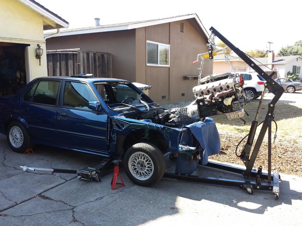

    Eric did you do it with the tranny attached?
    Is it very difficult?
    • Cabriolet
      • 9620
      #24467
      attach the tranny and starter before putting it in the car. same with taking it out do it all together.
      Much wow
      I hate 4 doors
      • mbonanni
        • Sep 2011
        • 6236
        #24468
        I did my swap with the tranny attached. It wasnt hard. Headers weren't attached and the exhaust was mounted on the car still. Those were difficult to mount to the block.

          #24469
          sorry only a cell shot

              #24471
              thanks.
              where did you mount the chain on the back of the engine?
              ill be doing this soon :D
              • Cabriolet
                • 9620
                #24472
                pants. right above the starter there is a hole that you lift from. i've found it very hard to get to with the starter in, is the only issue. i've also pulled engines and put them in, using the motor mount arms. this also works.
