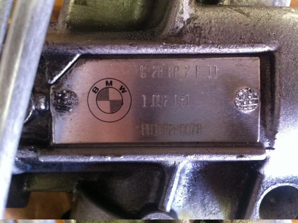

    Originally posted by Pantless Spency
    I really really need a 1.9 z3 rack.....
    I wanna have that, and control arms ready to go before I get my ground control put on so I only have to get an alignment once.
    Crunched my facts. 1.9s came with the e36 3.2 racks.
    6-cylinder Z3 racks are the ones you want (2.5, 2.8, 3.0). Part number ends in 031. Has a gold "sheathing" to it.
    Got mixed up cause I had a 1.9 shifter and confused the heck out of myself when comparing other z3 parts. How? Don't ask, I don't know
      Aw snizap.
      Anyone else verify this for me?

        NOR-CAL General Chat.
        Yes
        Ending sequence to the part number is the center line; it reads "1 092 031".
        Came off a 1999 Z3 2.8
        Verified 2.7L/L because I can turn my wheel and count at the same time
        But my experience dictates that you should not trust model/year regarding which z3 has the true-blue 2.7 L/L rack. Just go by the part number and you will be fine

                      Originally posted by Steven
                      Holy fuck. I noticed that gold sheth on the rack and my dad has the same one. Check the number and confirms it's the 1.9 rack... Wow we bought it in the understanding that it was a regular e36 rack. It was $200 new old stock and you could smell the old on it :P
                      I thought he said 1.9 was regular e36 and 2.8 was the 2.7 turn to lock?

                        It's a hit or miss
                        I've seen more 031 racks come from 6-cylinder z3s than 4 cylinders. HOWEVER, I've HAVE seen 1.9s have the rack, but no idea what determines if it has the 031 2.7 L/L rack or the 3.2 e36 rack.
                        You just gotta double check the part number and see if it ends in 031. That's the biggest tell-tale sign of the coveted 2.7 L/L z3 rack
