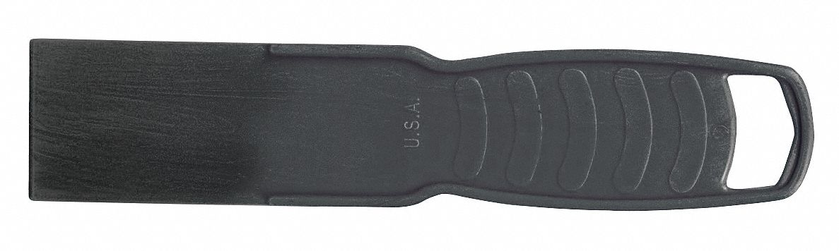

      Plastic or very thin metal flexible putty knife. I used a pairing knife the kind used to take the skin off an apple to insert into one edge of the oil pan. Then take your time and work it around the edges. Lots of breaks helps with the patience aspect of the job. Brake cleaner may help to break down the RTV as well. Chemical RTV removers are a waste of time. I had no luck using them at all.
      Grainger has a nice plastic one that will set you back a whole $1.25

          Thanks for the advice. I should have a couple of those sitting around, I'll start working them in with a dead blow mallet.
