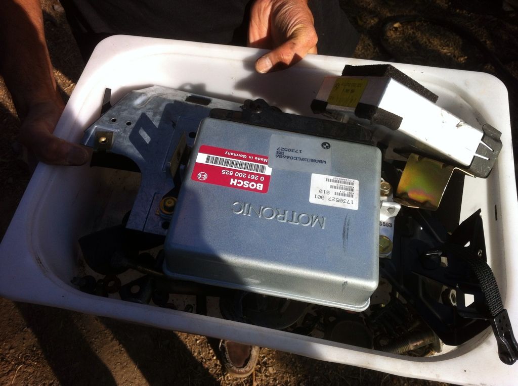

                  #11168
                  Originally posted by mbonanni
                  Yeah, that is a good suggestion, but I do not have a spare ecu. They are expensive to try right now.
                  If anyone has a 173 ecu they can let me borrow to see if that is the problem I would appreciate it.
                  Same ECU from a 1993 325i vert (m20)?

                    #11169
                    I am not sure, it think so. could you Look on the back of it and tell me the numbers?

                      #11170
                      Sorry it's upside down.

                        #11171
                        It is different.
                        Thanks though.
                        I need a 173

                          #11172
                          Pretty sure that'll work too.

                            #11173
                            I don't think so.
                            I have an '87 harness which is still early model, so I do not believe that one will work. Has somehting to do with the motronic stuff

                                #11175
                                He could borrow it for the cost of shipping ($13 because that's easiest for me). Or just buy it like 40 shipped, only issue is that I never started the car with it, but it definitely ran great into that tree.
