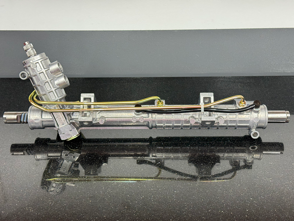

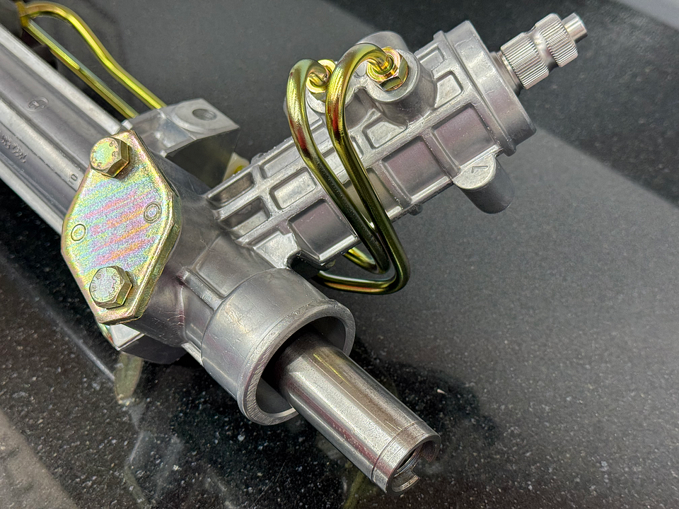

              • Jordan
                • 12916
                Not sure if you have already found yourself a good rack, or even need one at this point but I will begin offering concours quality reman racks for these cars soon. I'm currently building inventory
                -=Limited Availability=- Fully restored concours quality aluminum body E30 steering rack ideal for enthusiasts restorations seeking a rebuilt rack while wishing to retain the original steering ratio. Production date stamp & part numbers on data plate will vary! All directly interchange physically though non-M and M
                Tenured Automotive Service Professional - Avid BMW Enthusiast
                Vapor Honing & E30 ABS Pump Refurbishment Service
                https://mtechniqueabs.com/
