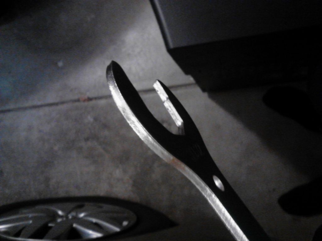

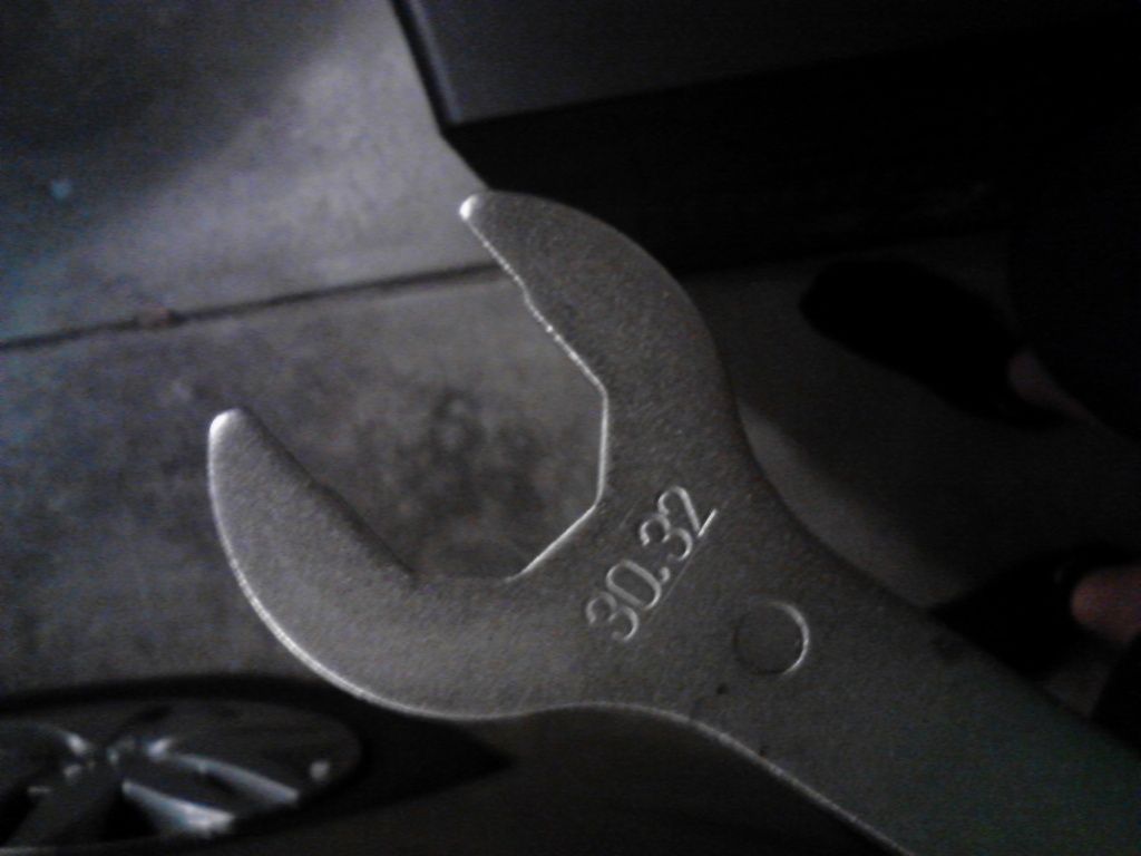

      That's what I've been trying but I don't have the wrench.
      Am I missing something? Harbor Freight seems to only have a 32mm "farm service wrench" which isn't long enough link. None of my local Sears for 50 miles carry a 32mm Craftsman wrench. Why is this so hard to source locally?
      Edit: I found ONE in stock at a local Sears.. Nobody steal it!
      32mm Combination Wrench

        Just borrow a bike tool kit!
        Edit: The majority of them will have this:
        • carwiz008
          • May 2012
          • 12
          I don't know anyone with a 32mm pedal wrench :(
          I found someone on Bf.c to borrow the wrench from, and Grand Thornton Sears has one if all else fails.

                    Thanks guys, I got it off with a 32mm wrench. I have an M50 and I already have a 16" Spal fan ready to go. I don't see how an air hammer and crow's foot would work in the low clearance area
