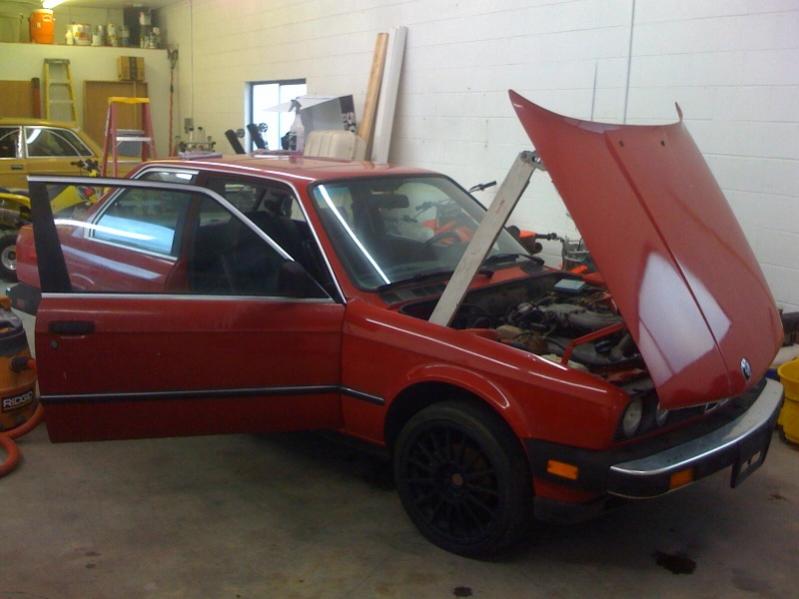

Anyone reognize this car?
  • Be30mer
    • Jan 2010
    • 1121
    i like your wheels, they kinda look like alpina's, but not as refined.
    You are lucky your Dad didn't pull out and leave you on the passenger side seat.

      Those rims remind me of those OZ Superturismo's in black. Hard to tell, but it could be those.

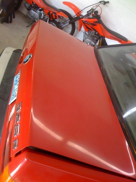

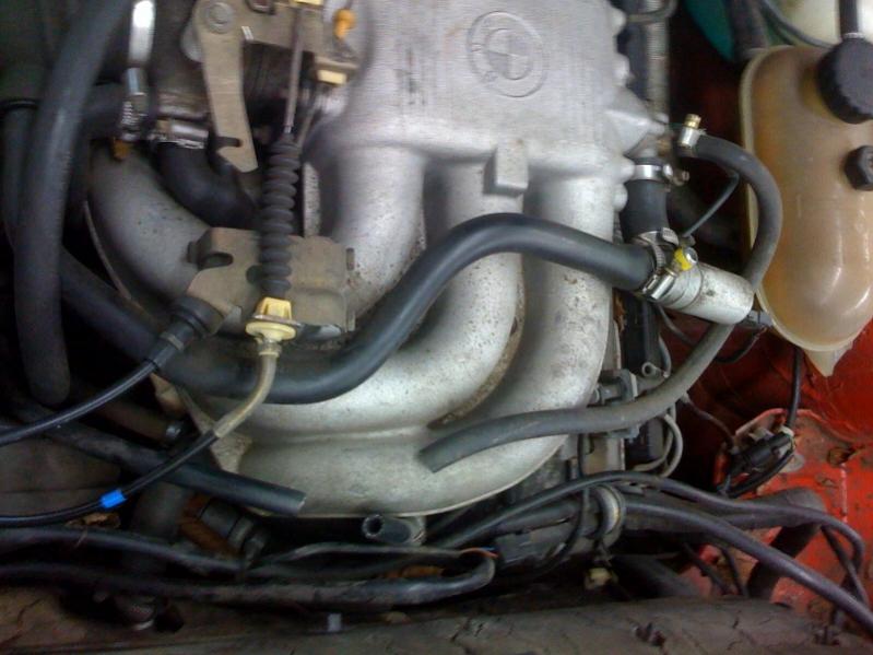

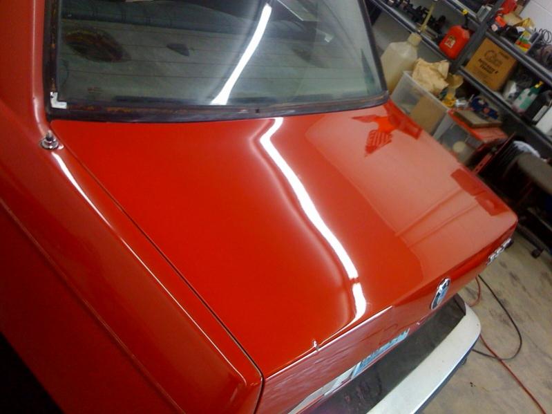

          Worked on it today- Cleaned it up, where do the hoses go.? (Fuel and?) The main shop (apexrestoration) cut and buffed the deck lid for me. Paint looks somewhat salvageable.

            2G pics FTL.
            Those are fuel hoses. There should be a T on the mail line from the filter to the back of the fuel rail (non-regulator end) that goes to the cold start valve on the manifold. Looks like you need some slightly longer lines and a T. I should have taken a peek on Sunday.
            I don't have a spare guibo, but my half decent one has held up for 30k so far :) I'm going to replace it and the CSB shortly, before they give up the ghost.
