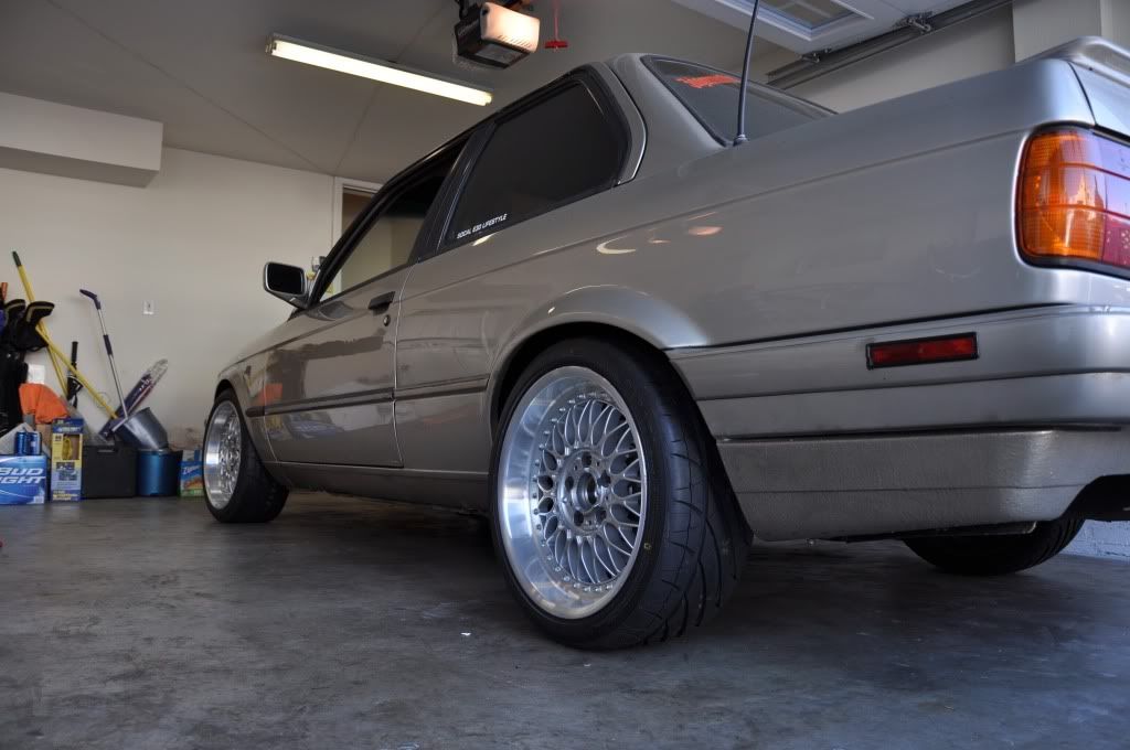

      Yeah that picture is pretty sweet you guys took. The more I look at them the more I am considering moving the DSII's from my M3 over to the e30 and getting something else for the M3.
      I will have an e30 M3 swap when all is said and done.
      No reason to spend the money on an E30 M3 swap if you're just going to put DS2's on the car. You would end up having to run 15-20mm spacers just to make them look good.

        Yes but there are positives to going this way as well. I can get the whole thing in one shot for $750 through a friend for e30 M3 and I like the fact that i can bolt it right on as I'm not the most well versed when it comes to modifying struts etc. and the ABS should work without any issues.
        i have sourced 318ti parts for the back but not having much luck with the e36 M3 front end anyways.

                Hey, thanks for all the feedback. I'm almost done with the swap. yes I spent around the $1500 in the end between plus some extra parts, poly bushings etc on top of that but I really like how it came out and if i ever decide to sell it the parts will probably be worth more than i invested.

                      i see you went with ET20 wheels in the end
