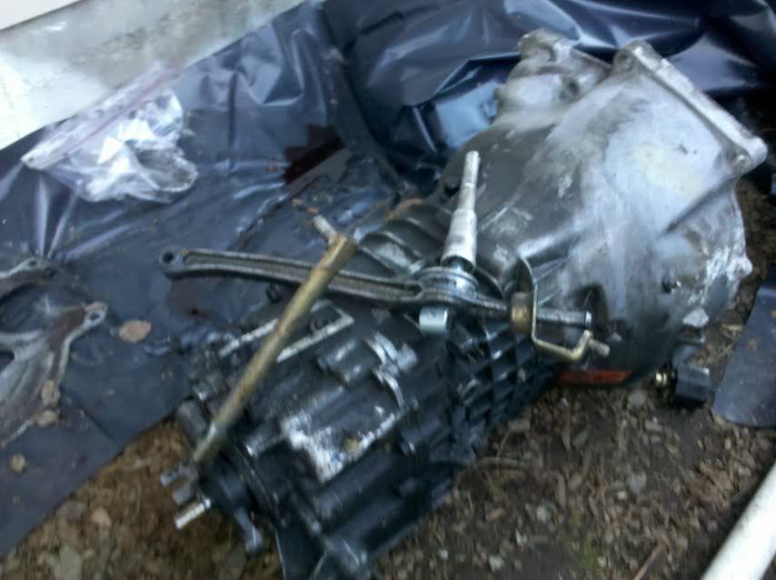

          Here's why I'm pulling the transmission:
