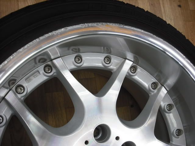

        I have used dependable wheels in renton. ... when my wheels got shipped from Japan to here, I didn't know they were bent. 2 of them had bends in them ( They have hollow lips )and I had all 4 lips needed to be redone. ..
        They will take u to the back and put your wheel on a balanced and show u exactly where the bends are. If welding is needed, they will charge u for that and more depending on how much welding is needed. Depending on the bend, simply fixing it will need welding cause of the stress put on it to straighten it out. When I dropped off my stuff, there was a 4-5 week waiting period since they were backed up...
        All in all I spent over $900 and the wheels didn't need welding. I was happy with the work and service but didn't like the waiting period. ... I had show quailty wheels and no one would picture how gouged up they were. .... ride quailty was perfect with no vibrations... I have pics if needed

            I can't find my close up after pics. ...

              it just looks like some curbage and it cost you 900?!

                It has chunks missing. .. can't find pics ....
