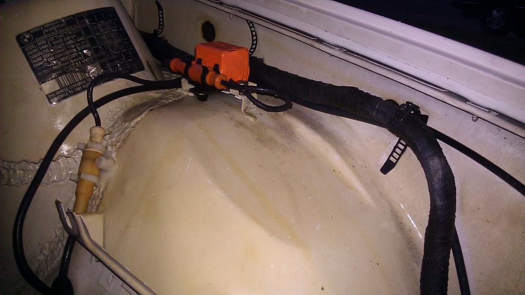

Isn't cosmoline there to protect the finish and so, the metal beneath? Is it really a good idea to remove it?Comment
I found that sh*t all over the fenders of my engine bay as well. Been just removing it with diluted simple green as I go. Some of it took a couple swipes with a soft brass brush, but I am also not really caring if my paint gets a little nerfed.1991 325i MT2 Touring (JDM bro)

thanks everyone ill try miniral spirits but will it mess up the paint? or could it?sigpic

ive used full concentrate simple green with goog results...elbow grease is definitely required though :p-Brad, AlphaTeam Motorwerks, LLC

Does anyone have any updates on this problem? i have the same issue with my engine bay and would love to clean it up.
I heard about spraying WD-40 on there for a period of time will dissolve the cosmoline into a liquid state allowing it to be wiped off. Anyone have any experience with this?1991 318i Sedan

I used mean green and a lot of elbow grease lol with the hard dish washing sponge, and again a ton of elbow greasesigpic

What a nightmare! i dont know if im ready to kill my hands doing it. Nasty stuff!1991 318i Sedan
