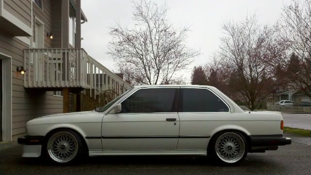

installed my "Is" skirts this weekend
  • PNWDan
    • Feb 2011
    • 1326
    Now I just need to figure out the rear valance..

        dont flame but I painted them myself haha. I figured they are only skirts and will get hit with all sorts of road debris because I drive my E30 50+ miles a day. I went to Wesco and had them mix the paint to match. I had them fill two rattle cans with the mix. I prepped them myself and sprayed them in the garage. I figured if it didnt work out, I would just get someone to do it again. They came out with a slight orange peel but nothing major. I flexed them all over before installing to check the adhesion. Im pretty happy with it actually. I wouldnt recommend this for big parts but the skirts are easy.
        I also didnt use the factory grommets in the rockers as I didnt want to drill and let rust form. I ran 3M trim tape the entire length on the top and used the clips on the pinch seam. The only holes I drilled were in the rear where the plastic rivets go.

                    One stage just like the factory Alpine. We'll see how it holds. Im not too concerned about the orange peel because standing next to it, you hardly notice it.

                    I went to Wesco in Everett. It was $60 for the paint and something like $10 a can. I have the leftover paint in a pop top can for touch up too. I like doing everything myself. I dont own an E30 just to pay others to work on it LOL.

                              Well its subjective LOL. It matches great actually but its noticable on the bottom a bit. The factory Alpine paint on the bottom of my car is a bit stained from years of road crud as I'm sure most white cars get. I need to do some cleaning with a clay bar or something and it will come back to OEM color. I held the skirts up to the hood, fender tops, and roof and its a dead match.
