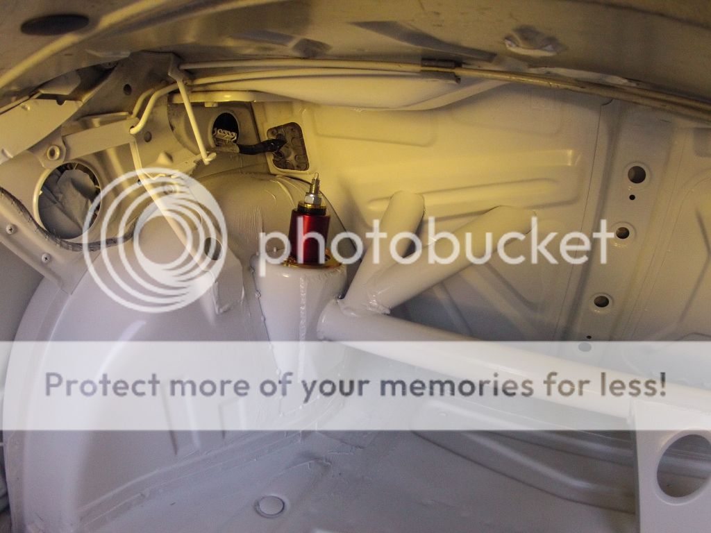

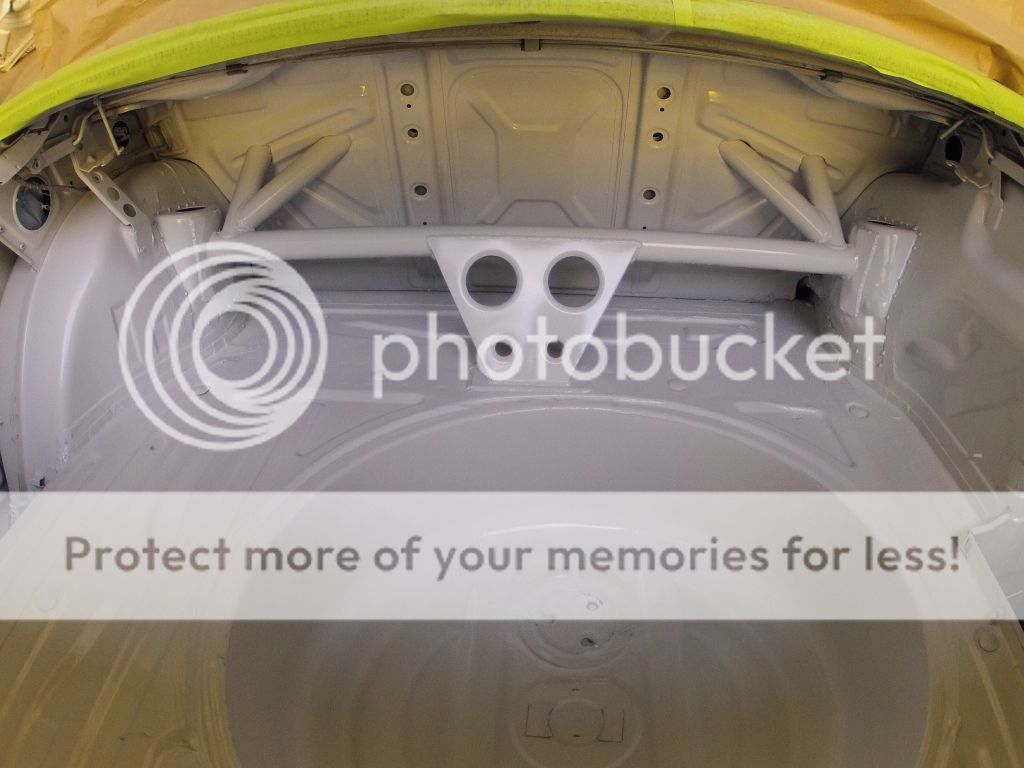

Here is the project for tonight. GC track setup. The Koni track valved and shortend fronts, 600# springs with the hybrid plate. Koni rears with the extended mounts, and 850# rear springs. Im gona run the factory front bar and probably pull the rear bar out. For now anyway.
Extended mounts are really nice. Gained some wheel travel and the springs stay in their perch when jacked up.
