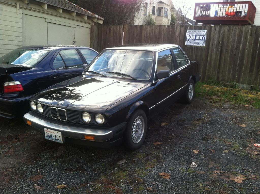

    Hey all, just got myself a E30 for the first time.
    Just wanted to show it off as it starts, ill be doing some work to it.
