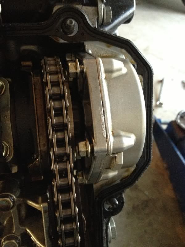

    Has anyone ever had issues with their m5x/s5x vanos housing bolts coming loose?
    I cracked open the valve cover to replace the valve cover gasket to find my vanos cover held on by the 5 bolts that were almost backed out to the point of grenading the engine! (literally, the picture shows how i found the bolts)
    Its not shown here, but there is a bolt near the bottom of the cover that i CANT reach for the life of me. Do you guys recommend removing the vanos, and tightening down the cover bolts w/ locktite, or is there some magical way to get a wrench in there to get that badboy nice and proper?
    and if so, which locktite should i go with?
    HELP!!

    I'm guessing they weren't properly torqued to begin with. Blue Med would be a good thread holder for those.

        Take it all apart. Rebuild the Vanos while it's out. Do it right.

            Seriously man...sketchy shit.
            Ya I'm guessing that was the case.
            That's the plan

              Scary stuff! Someone thought that was "Good and Tight".. Wondering if Erik is gonna see this! haha.
              You get your Vanos rebuild kit from DR. Vanos?

                    Haha ya, pretty scary. I guess the general consensus on m5x/s5x is that those vanos cover bolts can back out due to the oil pressure build up, and overall vibration the engine produces.

                    Haha no worries man. I'm not pointing fingers. I posted this to get a general idea of what I should do. Looks like I'll be removing the unit, and locktiting the shit out of the bolts lol.

                          Damn, that's fucked up man! I almost don't want to say who the last person was that touched that... :/ I'm glad you spotted it in time too. You trust people that are supposedly experienced and proficient at their profession and then you see things like this. :-( Makes me angry. All I can say is that I didn't put my hands on that so I didn't under-torque them personally.

                            I was if you didn't touch it supposedly. Everything was torqued to spec. If you don't believe me, Erik, talk to Luke Fischer. He was there for the entire thing. Unless you think we're both lying?

                              If I recall, he had a shop do something with the vanos unit...I could be wrong but I was there with Brad when he bought the car and I could have sworn Erik had an independent shop do something with that vanos unit.
