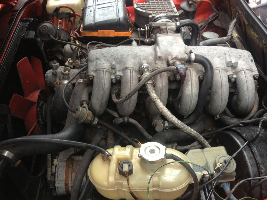

      Those photos doesn't quite convey it - is there a long, raised coolant passage on the driver's side? That's the only reliable way to tell an M90 block. The stock M30 one is a few inches long, the M90 one runs 2/3rds of the block length and sometimes has a big L drawn on it. 3.5 block stamping is not reliable.
      sorry, M90 identification is not straightforward, it's a weird engine...
        The coolant pipe looks exactly like the one in that picture. I tried scrubbing away at the side of the block with a brush and some cleaner but didn't find the white "L", though.

          cool! probably an M90 indeed, shame it has to go. How bad is the dash?

                  B35 cam slides right in, sensors hook up, and then you have a M1.3 M90.
                              There should be an X for the B35 on exhaust side.
