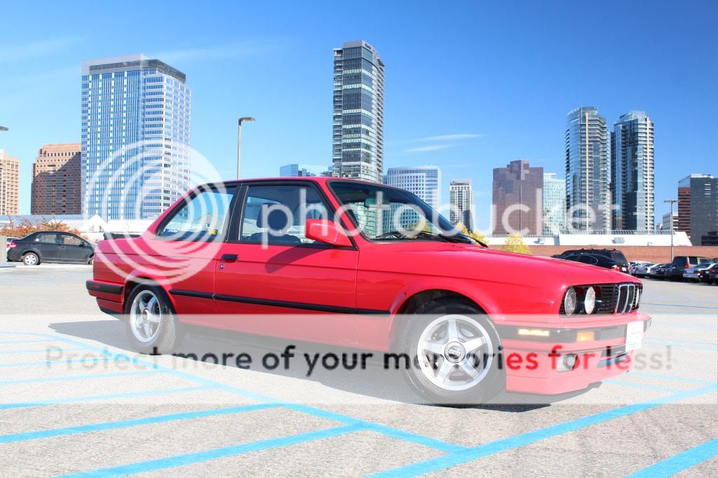

    The ride was great. The spring rate was comfortable but stiffer than stock. The ride height allowed for driving like a normal person. If I were to get another E30, I would do the exact same suspension.
    _MG_8410_5005 by Twelvizm, on Flickr
