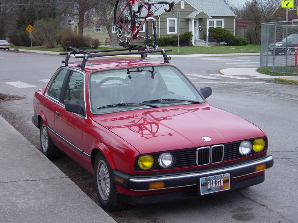

                      Home. 1500 mile adventure. All good. E36 rack planning underway.
