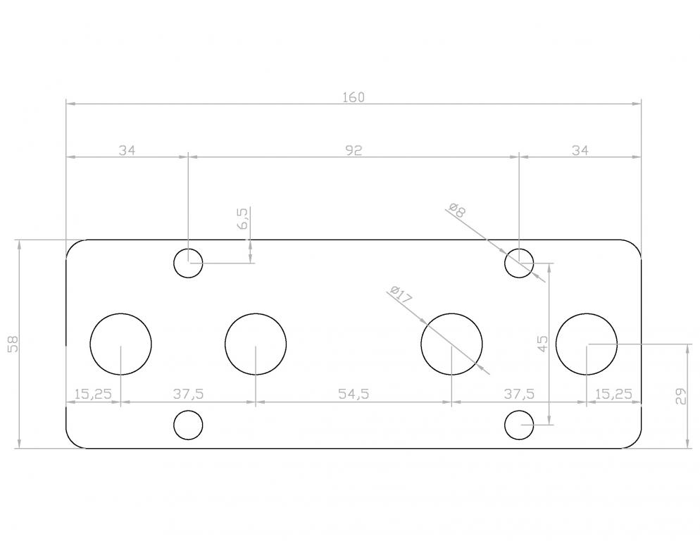

        Valve seals can be installed with an appropriately sized socket.
        As far as a valve spring compress, I HIGHLY recommend this style:
        https://www.ebay.com/itm/BMW-Valve-S...8AAOSwqDha~zVG
        I made one by simply drilling holes in a 1/4" thick plate and used tubing as spacers. No need for the recessed pockets. I attached a picture with measurements.
          The m20 is a bit different, not sure how well that would work.
          I have had one of the c-clamp styles for years, don't remember paying a lot for it at the local box parts store.
