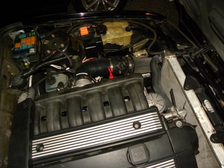

    Hard to believe it has been 7 years since the swap. It has been trouble free and fun once I got the rear trans mount aligned with the drive shaft. Needs a new flex disk now though. 40,000 miles is a great run. The fan looks a little funny since it is on backward. The front of the car was not properly repaired from a previous owner and clearance to the radiator was about 1/4 inch too close. By turning the fan backward got the space needed and enough air to cool so works well.

    Engine is 2.8L from 1996 E-39. Has S52 Cams so makes lots of power. OBD 1 intake etc.
