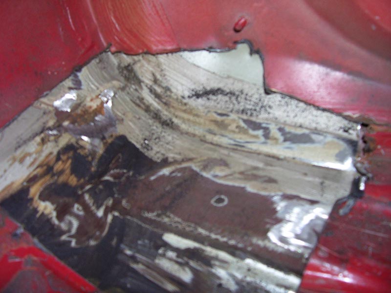

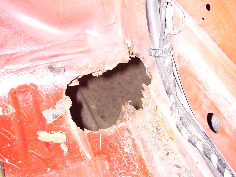

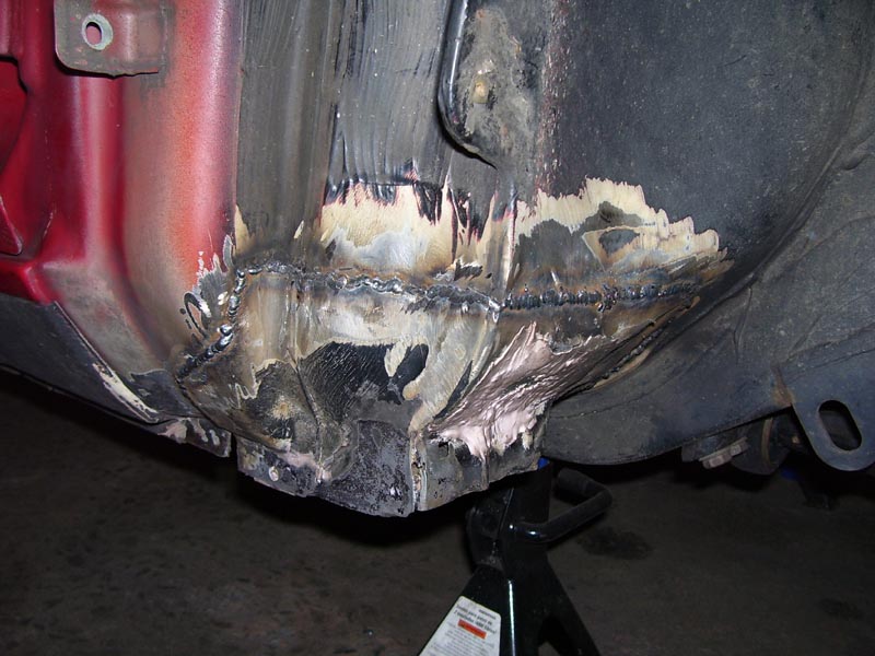

    The 87 325is track car had some rust forming in the floorboard. I went to jack up the car from the square lift point, which then went up into the carpet. So began the surgery:
    • Cut nice big square area out of floor
    • Cut similar square, but ~1" bigger in all directions, out of parts car (89 325i)
    • Clean all the undercoating and paint from area
    • Discover rust in replacement panel (DOH!!!)
    • Clean away rust, find a 1" hole left over
    • Weld new metal into replacement panel
    • Weld panel into car (from underneath, so it overlaps)
    • Grind welds, seal it (used body filler)
    • Spray undercoating
    • Spray duplicolor red on inside, which is pretty close to zinno (close enough for a track car, anyway)
    Obviously, this is far from professional, and was done in the spare time I have between full time work and school, to get a track car ready for the season. So don't bust my balls too bad

      Nice work, but im pretty sure thats NOT a jacking point.

          That square is not a jacking point? I most often just use the frame rail anyway, but every shop I've ever been to has used that square.

                      Do yourself a favor and remove the rest of the sound deadening, a lot of hiding places for rust.

                          Yep, it's already gone. I've found a very small amount of rust on the drivers side floorboard, but due to time constraints it's going to have to wait til next winter. I know it will grow, but I simply don't have the ability to fix it if I am going to get it back on the track for the two series that I run.

                            I would recommend applying primer before applying paint and undercoating.
