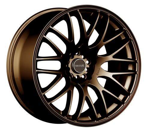

    I am looking at a few sets of wheels for the iX. I'm thinking upping to 17x7 with an offset somewhere around +35 to +42... I'd like either 5 spoke or a mesh type of wheel. I don't want to break the bank, I don't abuse the car or beat on it too hard.
    Wheels I'm thinking about:
    XXR 530 17x7 +35
    XXR 962 17x7 +40
    Tenzo R Type M 17x7 +42
    As far as tires I'd like something around a 205-215 with a sidewall of 40-45ish... Not going low with the iX.
    Anyway, here is a photo for reference, not mine, but very similar.
    Thanks R3V!

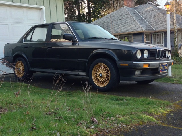

      Just paint your weaves? Can't beat 'em for like $50 and elbow grease.

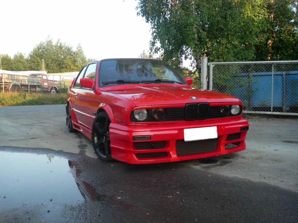

                    Ok. Shit this is not nice job, very difficult choise right tyres . -
                    -Some one use in ix like this tyre+wheels option 17x8 et30 w/ 215/40. He said to me not problem to use 215/40 at those rims and stock suspension parts.
                    -And here is a nother option 8x17 et35, 215/40/17 all round+ -40mm lowering, still fit rotation, no proplem.
                    HOW about 205/50 are there any better choise??.
                    Becouse 205/40 tyres whit 7x17 ET35 rims is not option for me, my old ix had those tyres and -60mm lowering, in road use, those are terrible to drive. Only positive is good feel on the road. And I measured, so the back would have been able to put a 20mm spacer and in front of more than 10-15 mm spacer.
                    I think I'll change the shock absorbers at the same time + some different springs so i get liittle more height than stock and a little harder platform

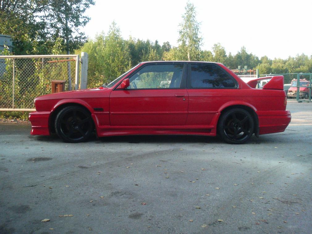

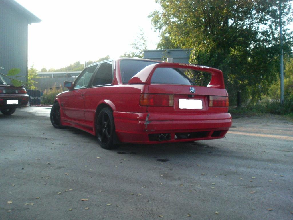

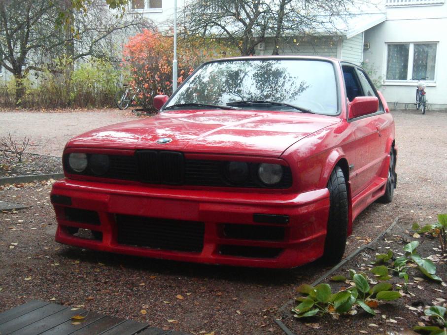

                          I finally found pictures of the old ix. Tires are 205/40-17, rims 7x17 ET35 and-60mm lower than stock. Check that back wheel. I measured when the owned this, as back would have been able to put in the back 15-20mm spacer would fit rotate. I do not quite remember the front.
