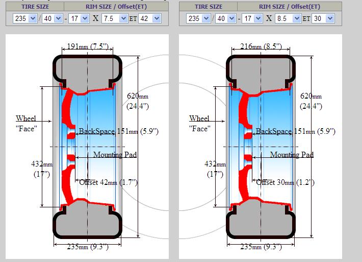

                          #42
                          235/40/17
                          17x7.5 et 42
                          lowered with H&R and Bilstein Sports

                            • downforce22
                              • Aug 2009
                              • 3192
                              #44
                              No spacers. The tires are 9 inches wide and are real close to the strut towers on both my lowered and stock height iX but clear it. I misspoke and offset is 42mm but it still clears without problems. I think you might be able to fit 17x8.5" wheels if you had an offset of about 30mm. Any higher and you will start rubbing the struts. You might still rub the frame rails, but anything much lower than 30mm on an 8.5" wheel will rub frame rails at full lock.
