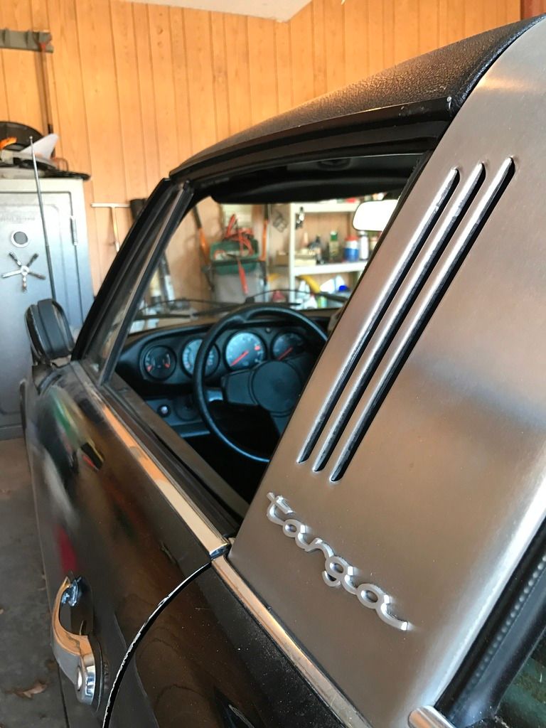

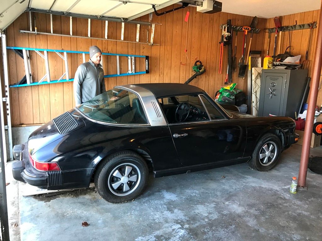

    Details:
    Originally a Cali car. Original owner had it though 2003 and put all but 400 of the 99,XXX miles on the car. I am the third owner.
    5-speed, factory AC, power windows, new top around 2002 (still looks like new), engine supposedly has stronger aftermarket studs (but no paperwork).
    The car has not been started or driven in at least a couple of years, but it cranked without issue. Seems like it's not getting any fuel. I plan to tow it home tomorrow and get to work. I'm open to any tips or tricks - I'm new to these.

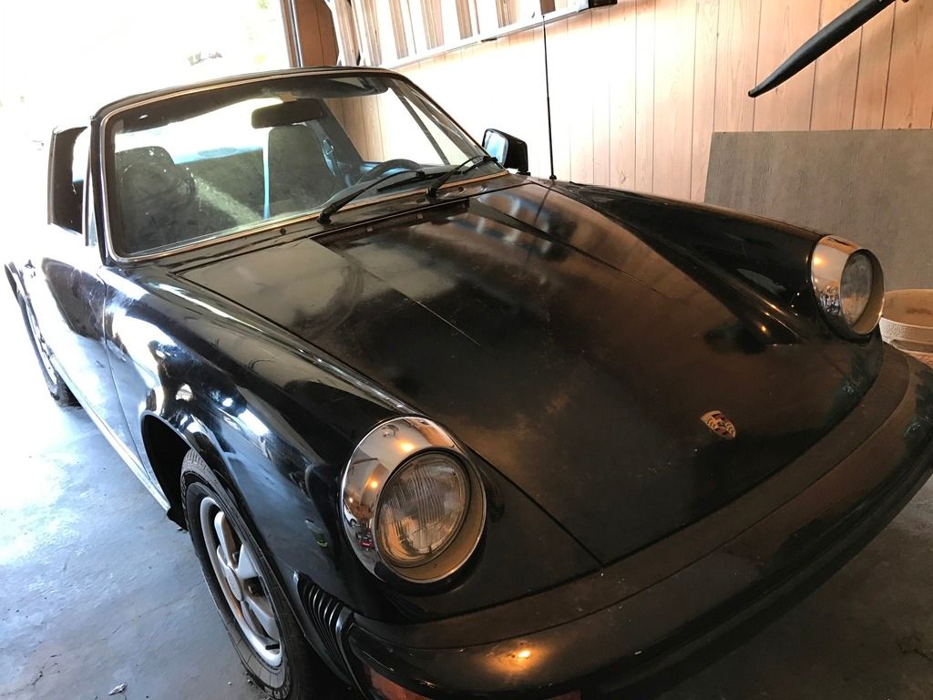

    ^^^These two things and the oil puddle underneath would be my concerns on a 2.7. Any way to verify studs without a teardown, you Porsche guys?
    Does it still have the thermal reactor exhaust set-up? Does your state require original emissions equip? That was one of the big problems as I understand it - heat. Get rid of those if you can.
    Then I assume, from sitting, the rubber is all shot - hoses, vacuum lines, all of it.

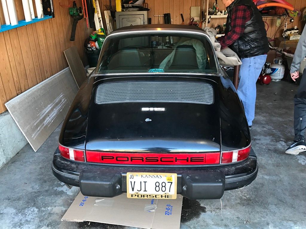

                    I dove into the car a bit today and determined that while she has spark, there is not any fuel.
                    I plan to drain the tank, replace the fuel sender, pump, and filter, blow out the lines, and go from there. It may not all be entirely necessary, but that should make the fuel delivery system (from tank to filter) pretty damn reliable.
                    From there I hope she starts so I can begin to diagnose the oil leak(s) - hopefully singular.
