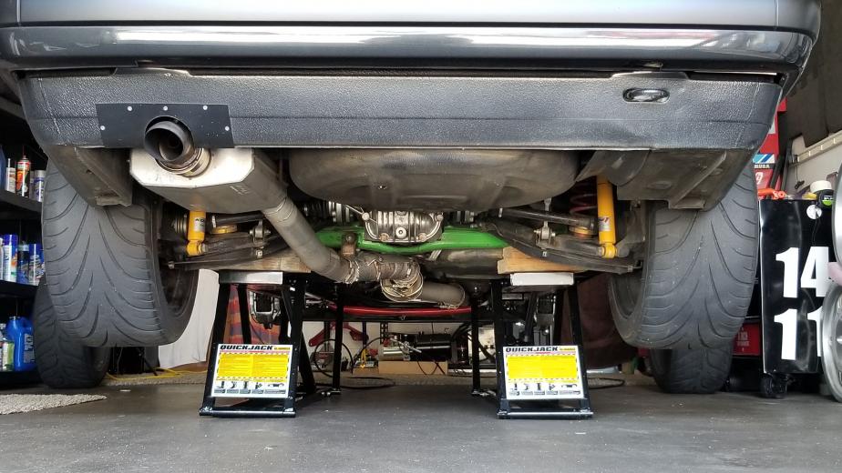

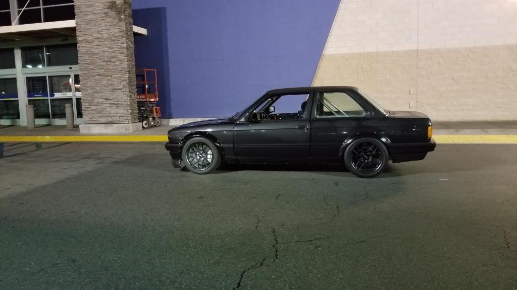

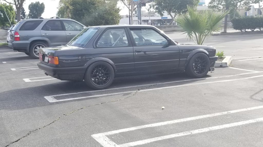

      Some quick pics from a few years ago. I'll take new ones next time I wash the car.
