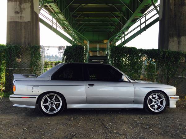

    e30 M3-$25,000
    1988 m3
    Approximately 100k chassis miles, 13300 miles since rotisserie restoration and repaint

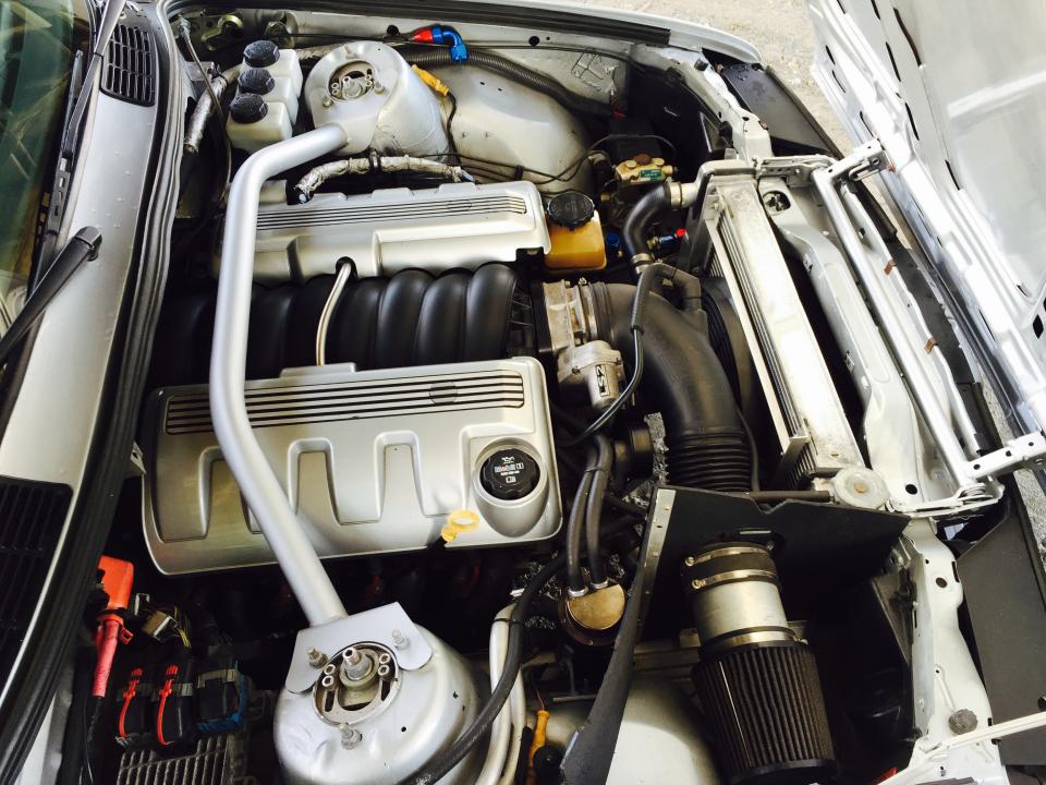

    Engine:
    6.0L LS2
    34k mile lift out from a 2006 GTO. Stock internals.
    Underdrive crank pulley.
    Stock computer, reflashed for tune / remove emissions. Tuned for 91 octane.
    Custom built headers. Ceramic coated. 1-3/4″ to dual 3″. Necked down to dual 2-1/2″ x-pipe, stainless exhaust.
    New fuel system. Walbro in-tank sends fuel to aluminum swirl pot, Bosch 044 sends fuel to fpr and engine. All new 3/8″ hard lines (all an6 fittings) and new flex fuel lines. (NOT stainless steel lines that permeate fuel.) Fuel pressure gauge.
    Cadillac CTS-V oil pan. (6.5 qt. pan) with Improved Racing oil cooler adapter and -10an lines to oil cooler up front.
    Accusump oil accumulator currently removed and lines capped. Easy to reinstall (comes with car).

    Chassis:
    Genuine EVO front fenders
    No headliner right now. Can be put back in
    Momo steering wheel. Steering column lowered.
    All wiring removed. Systems separated. All new power distribution. Maintained working lights, blinkers, hazards, wipers, abs, p-windows.
    Vintage Air heat installed
    $25000 . FIRM
