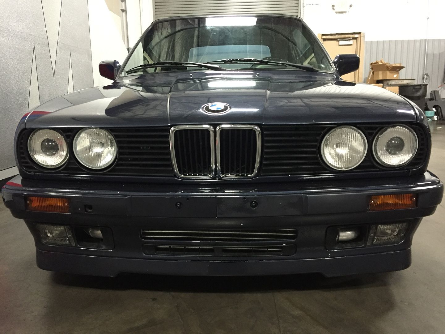

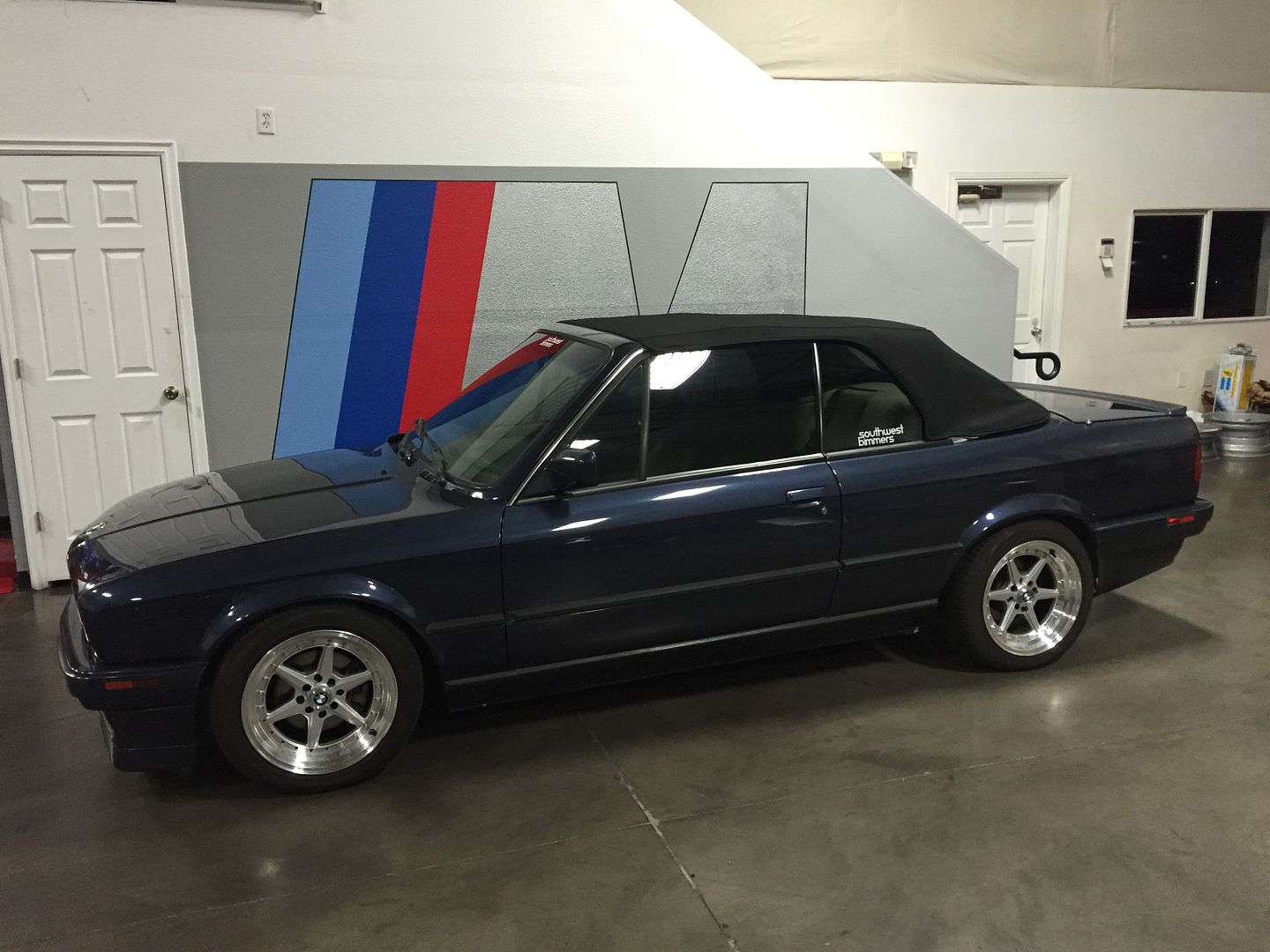

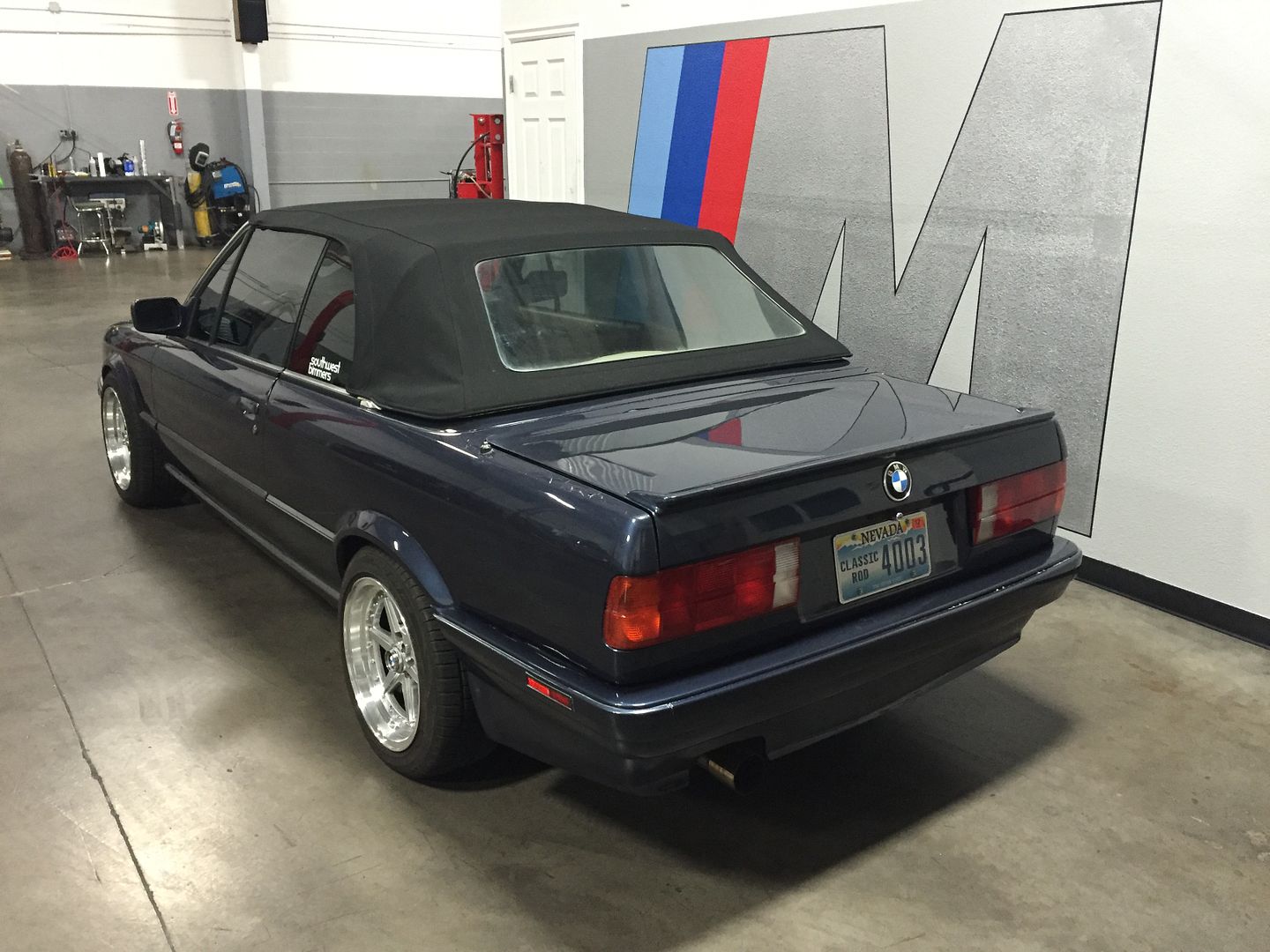

    asking $7k - we have many dyno sheets for this car, it makes around 550hp at the wheels and over 600lbs.
    1989 325 with M50NV 3.0liter 11:1 turbo - plastic bumper conversion - VEMS 3.6
    car has anti lag, boost by gear, and ignition shift cut.

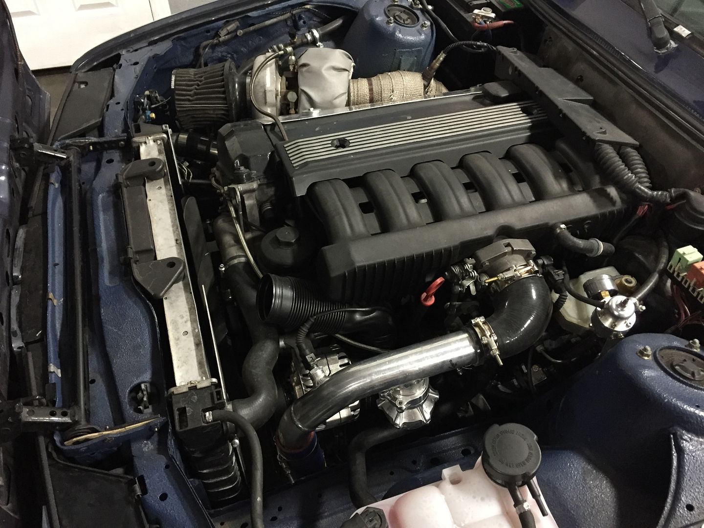

    engine
    VEMS 3.6 - e92 335 coils
    m54 3.0 crank
    arp - main studs - headstuds
    bearings and rings have been replaced
    new chains
    new guides
    new oil pump
    new water pump - metal impeller
    oil filter housing off of a m54b30
    updated power steering pump from a late e46 to increase steering assist
    stock mechanical fan - stock radiator
    new belts
    new belt tensioners
    New fuel lines - including the ones around the fuel tank
    New breather hoses
    Vibrant air filter
    Belts

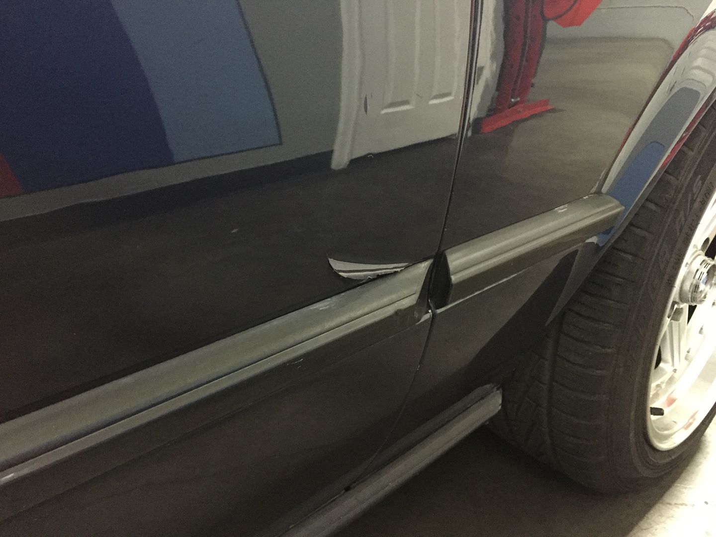

    The bad - could use new seats - The seat frames and foam are in great shape but the leather covers should be replaced
    The paint isn't in great shape - someone did a quick spray on it and didn't prep it correctly.
    only the seat heater on the driver seat works. I would fix the passenger but I don't have any extra heating elements to install.

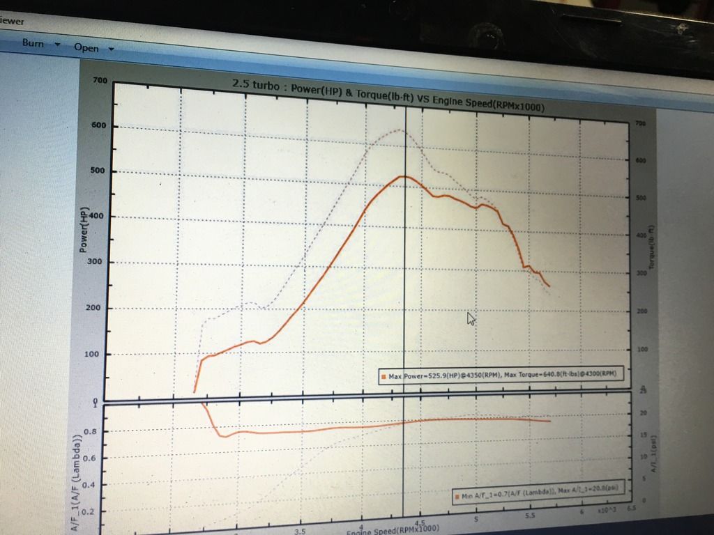

                  heres the dyno graph for the car.

                      What type of connecting rod and bearings were used in the build? How many miles on the car after 550 hp?
                        Stock rods and stock bearings. I don't know how many miles, we don't daily this car. We only use it for drag racing and autox events. If someone was trying to daily this or make the motor last for a long time you would probably not want to keep it at this power level. 400hp in this kind of car would be more than most people would need.
                        To turn the power level up or down on this car:
                        plug in to the VEMS, go to the boost controller settings and lower the target boost.
                        We are restricted to 5000 miles a year on the street because of the way it is registered. We probably put 3000 miles a year on it.

                              When you say; stock rods and pistons. Are the pistons and rods from a m50nv or is all internals from a m54 like the crankshaft? ?
