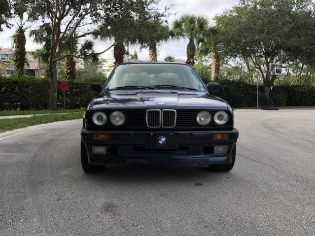

      VIN indicates that it's a 325e (not a 325i, which didn't come in 2-door till 1989).
      Someone swapped the newer plastic bumpers onto it too (that's a good thing).

            Knowing that there was no 2-door 325i model offered in 1988, and seeing the later model plastic bumpers, i entered your VIN into the ETK and it comes back as an 88 325e which came with the low-RPM 2.7 Super ETA engine. You should be able to visually identify which engine is in that car (although i don't remember what to look for).
            Also post a clear picture of the tachometer for us - the ETA models have a much lower redline than the 325i.
            Pictures of the car and interior would also be helpful, and you need to tell us the asking price of the car.

                In one of the pictures you can see the tach redline at 5 and end at 6. 325i's have a tach that goes to 7.
                That's a Super-ETA. Beautiful car though.

                  +1 super eta tachs go to 6k
                  the seta is the best candidate for a 2.7 swap tho, if the new owner could source 325i head/intake/exhaust etc and inevitably a 5 speed swap and sport seats...

                    Look at the manifold. It's a super ETA. 6k tach also confirms that. Cool to see a late model car, finished in Royalblau. GLWS

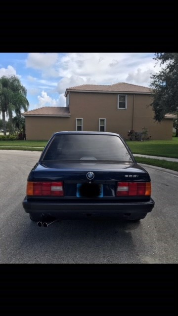

                        Hi all! Thanks for the interesting facts! Other than what you are all saying how would I ever know. I mean by seeing the carfax (which I see can be inaccurate) and by seeing the 325i emblem in the back I wouldn't think twice. I mean I do know anyone can put any badge they want on a car since it's just a sticker, but since Carfax said it was a 1988 325i I just didn't think twice. I am going to run a check on AutoCheck. A friend that owns a car dealer told me today that it is more accurate and said the same thing about Carfax.

                              Someone in the car's past has done some light modding for whatever reason - the bumpers are from an 89-91 (like i did on my own 88 325is), and changed the trunk badge to i, providing the trunk lid is the original one with matching VIN sticker. I presume the car's paint is original no?
                              I'm sure Austin is correct. Some years ago a family friend had an immaculate 2-door '88 automatic and i remember the trunklid emblem was just 325 (like he said with no e or i after the numbers). I thought that odd that there was no e like previous years but the car was all original, then i later learned they dropped the e that year and improved the ETA engine. I think '88 is the last year for the ETA engine too.
