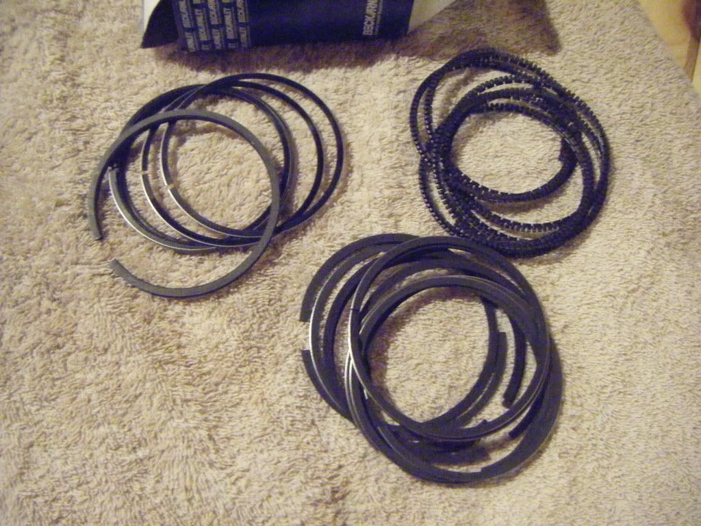

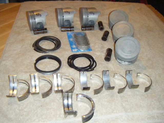

    Unfortunatley plans have changed and I am no longer moving forward with my stroker build. It pains me to sell these parts, but hopefully someone else can find a home for these parts and put them to good use.

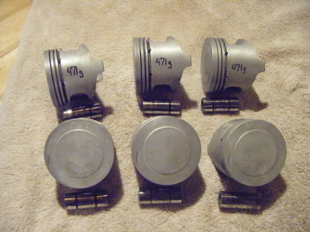

    Early Euro ETA 11.2:1 Compression Ratio Pistons - If my memory serves me correctly these piston in an eta lower end with an "885" will give you a compression ratio of 10.2:1 these pistons were all balanced with thier wrist pins and come in at 471g each. - $350 Shipped SOLD

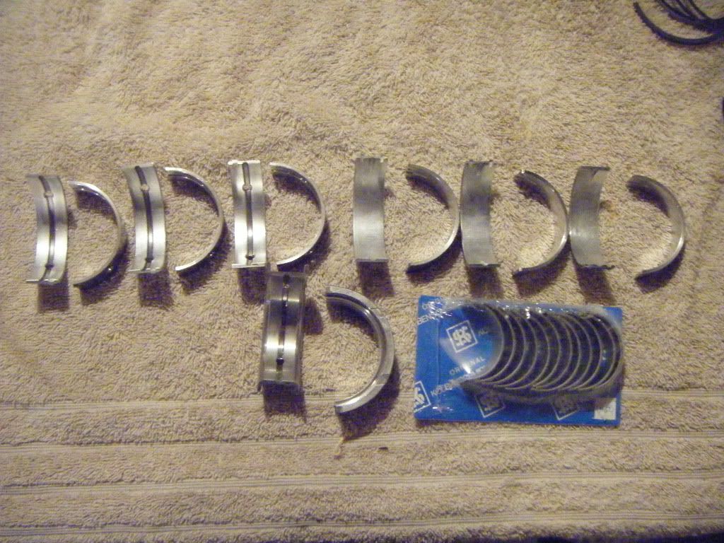

    Brand New engine bearings standard size - $80 Shipped SOLD
    ETA Piston Rings - $75 Shipped SOLD
    Or $450 Shipped for everything (pistons, rings & bearings) SOLD

              Those look like my old pistons, if you buy them, the wrist pins are numbered to match the pistons for balance.
              He is correct, with the 885 head, you will have a static comp ratio of 10.2 to 1.

                            early or late model bearings? Also what brand?
                            PM me bud very interested.
                            • ForcedFirebird
                              • Feb 2007
                              • 8300
                              The pics show a grooved and solid shell, that would be late model. Early had grooved shells on both halves.
