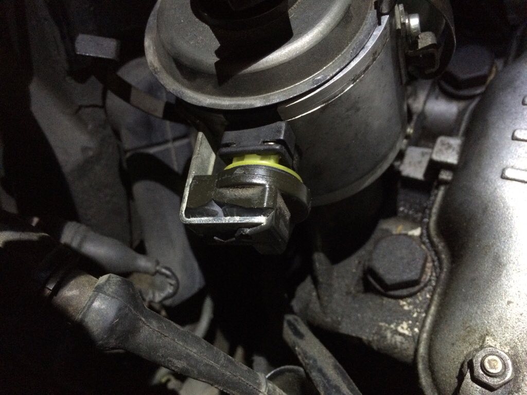

                  Hrm, distributor didn't work. Fiddled around a bunch and wouldn't even tick over. Put the old one back in and it fired right up.
                  There are differences, the 85 had a ground terminal coming off the side (wasn't hooked to anything) and the 84 had a different pickup coil plug with a different retention clip / screw setup. It made contact, was snug, but wasn't mechanically held in. I tested the coil with a meter and it sits about 1k ohms and drops out when it passes the (i'm guessing) magnet every 1/4 turn. Didn't test my old one, just wanted to get my car running and home safely.
                  In addition to that not working, the 84 had a lot more up down shaft play than my 85. It was a millimeter vs 3 millimeters. Doesn't sound like much but it is when you have them side by side.. Part numbers are different too, but the all powerful internet says they're compatible, and not compatible. Good grief.
