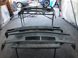

Part at the bottom, closest to the camera is a 771 US market (USDM) diving board valance. the 772 will replace this part. You probably thought you still needed it because the strip across the top was missing from your angled eurovalance. You don't.Last edited by bradnic; 03-17-2017, 06:14 PM.Leave a comment:

the lower edge of the "angled" eurovalance bolts to the rad support. when you look at it from the side, the lower edge is further rear than the top. The part numbers of this angled valance are 41331916986 (lower piece) and 41331884353 (thin metal piece above the bumper).
here's the 353 thin strip part. you can still order it from BMW since it was used on the 84-85 E30s. But remember it only works with the angled lower part.
The newer (10/85 through 87) "flat" eurovalance used with chrome euro bumpers is vertically straight. when you look at it from the side the top and bottom edges are vertically aligned. There are two flat chrome bumper eurovalances, 41331933770 (missing AC vent holes) and 41331933772 (the one everyone in the US retrofitting chrome eurobumpers really wants).
like I posted earlier, don't bother ordering a 772 from BMW. they'll ship you a 771 with a 772 label on them. 771 is the standard US metal valance for diving board cars.
there is one more valance that's only for plastic bumper cars in both US and europe, part number 41331961227.
