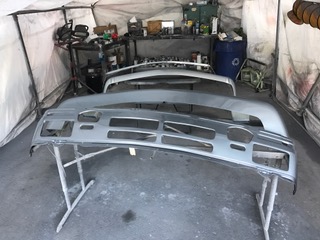

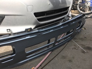

Here are some pictures of the euro valance like requested.
I'm not trying to confuse anyone, sorry about that. I may not have enough knowledge about the valance. I know that there were two distinct kinds made for these cars for early model. However when I purchased this particular valance from Classic Euro Parts, first they didn't have in stock the smaller kind that I think may fit my specific car. I made sure to ask seller a question on eBay messenger for fitment giving specific year and model of my car (1987 E300 325i US spec). He told me that this euro valance will fit just right. So, I was just going off of the information given.

Exactly. Post pics. These guys sell both the 83-85 1 piece euro (angles in) and the 85-87 flat euro valance. There's a 2 piece early euro as well, where the strip above the bumper is a separate componentLeave a comment:
This.
There is two distinctly different Euro metal valances, and anything that is designed for one (Alpina, Hartge, M-tech, Jimmy Hill Lip..etc.) WILL NOT work on the other. At all.Leave a comment:
Sounds like you have the early model euro valance
Post pics before folks start jumping to the wrong conclusionsLeave a comment:

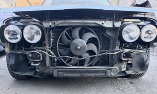

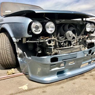

Great info on the "euro valance" It looks like another product CEP will have to take back to the drawing board. Glad the front valance fit well. We all have had good luck with it as well. now for the mtech 1 side skirts....A little update on my M Tech 1 front and euro valance. So it appears that the valance doesn't fit and the whole structure of that "euro valance" is very different from the one I have on my car. It doesn't have the top bar that connects left and right fenders and basically there's no way to screw it to the car other than there are two side holes that are supposed to align with lower parts of the fenders but it doesn't fit. Also it looks like it's not meant for cats with ac or at least my ac radiator is on the way. My us spec valance also has two extensions sticking out of it that are factory welded to it that connect to the frame and there are holes to screw it. Nothing like that appears on the "euro" piece. Bummer, because even if there is a way to force the euro valance to fit there would still have to be a lot of cutting g and welding done. I was under the impression it should fit any model, even after restyling models, so I fear it is just a defective piece. Very disappointed, now have to just cut out my us spec valance to make space for fog lights. Also, original valance overall seems more sturdy. So if any of you had dealt with this issue please advise.
On a positive side M Tech 1 front cover fits ok. It aligned just right and I can pretty much confirm that "plastiflex" is pretty flexible:) Had to bend parts of the skirt pretty hard without problems. Holes drill well too, definitely much better than regular fiberglass. I should finish putting together my bumper and polish everything and then will post photos of the completed bumper.
