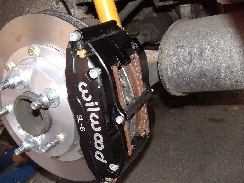

          Kits also available for the e36 and e46 chassis. All kits include the caliper mounts, fasteners, fittings. Parts are anodized clear, yellow or Gun Metal.
          e30 race kit pictured below - $450usd/$510cdn for installation package - Calipers/discs extra.
          street kit (thinner discs/11mm more clearance) coming soon - $500usd/$570cdn.
          Brackets have adjustments allowing 11.75" discs as well as 12" ones. 11.75" pictured.
          Perfect fit in pad location and caliper offset. 0.1mm accuracy.
          Yes I know, the bleeders are upside. That was just for the photo

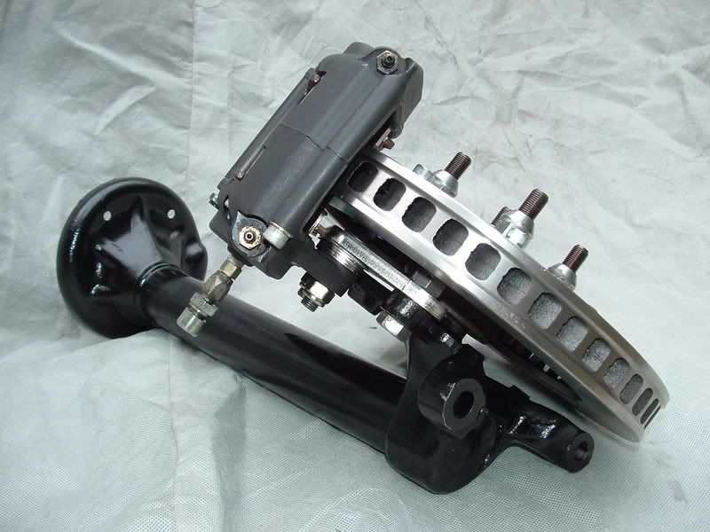

          e30 M3 rear kit. Stock rear discs vs Massive kit. Rear kit available soon for e36 chassis too.
          Rear e30 M3 kit installed. Those 12.2" x 1.25" discs in the back are wider than any front rotors on any BMW. They also are bigger in diameter than most front ones.

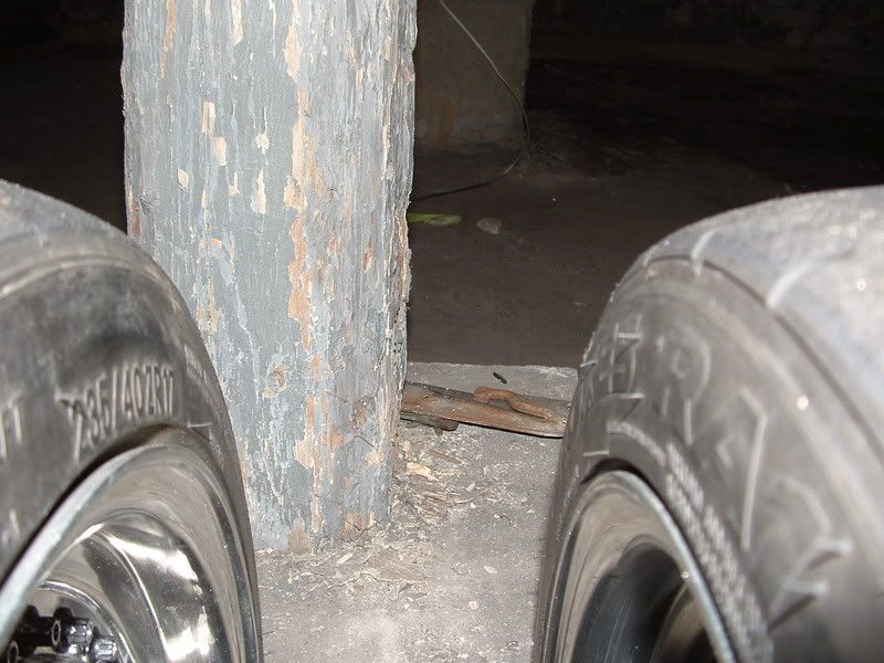

                        If you run 235 or 245 rubber, may I suggest that you use either 8,5" rims for the 235, or 9" for the 245. Look at the picture. Same 235 rubber. On the left with a 9" rim, on the right with a 8.5" rim. You can see that 235 is stretched on 9" rim while it sits perfect on the 8.5", but for 245 Hoosiers, then the 9" rim is perfect.
