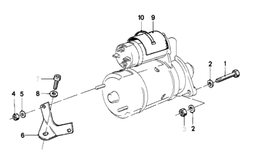

    Hi, I am looking for the late model starter bracket, #6 in the picture, that mounts and supports the starter to the block. I removed the big old ETA starter and replaced it with the late model starter but the bolt holes do not line up on the old bracket.
    If anyone has this part please let me know, Thanks!

    I could be wrong, but I'm thinking the late starters did not use the bracket. Anyone else have thoughts?
      I thought the same thing
      • nando
        • 34847
        I don't think I have ever seen such a bracket on any of the late E30s I've worked on. Probably not needed on the newer, lighter starters.

          that is an e36 part. not necessary on the e30.
            Actually is E30M3 part, P/N 12411308480
