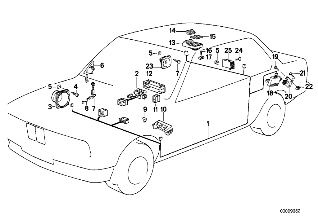

    Hello everyone.
    I understand that the thing is so rare that the search will not be easy. Nevertheless, I do not give up and try to find a new or used complete wiring specifically for the version with a two-door or four-door E30 (convertible and station wagon with other wiring options).
    There is one option on eBay, but the person there gets in touch but doesn't want to make a deal, in general a strange offer.
    I'll buy both the wiring separately and with the amplifier and rear speakers too.
    Any offers will help me assemble my dream!

        Hi. Yes, I saw this wiring, it's strange that its catalog number is not compatible with my diagram by VIN code. In this case, I'm worried that there may be problems. I wouldn't like to risk it.
