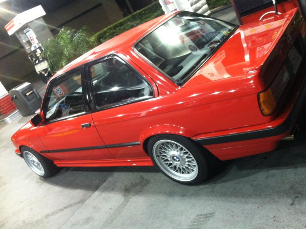

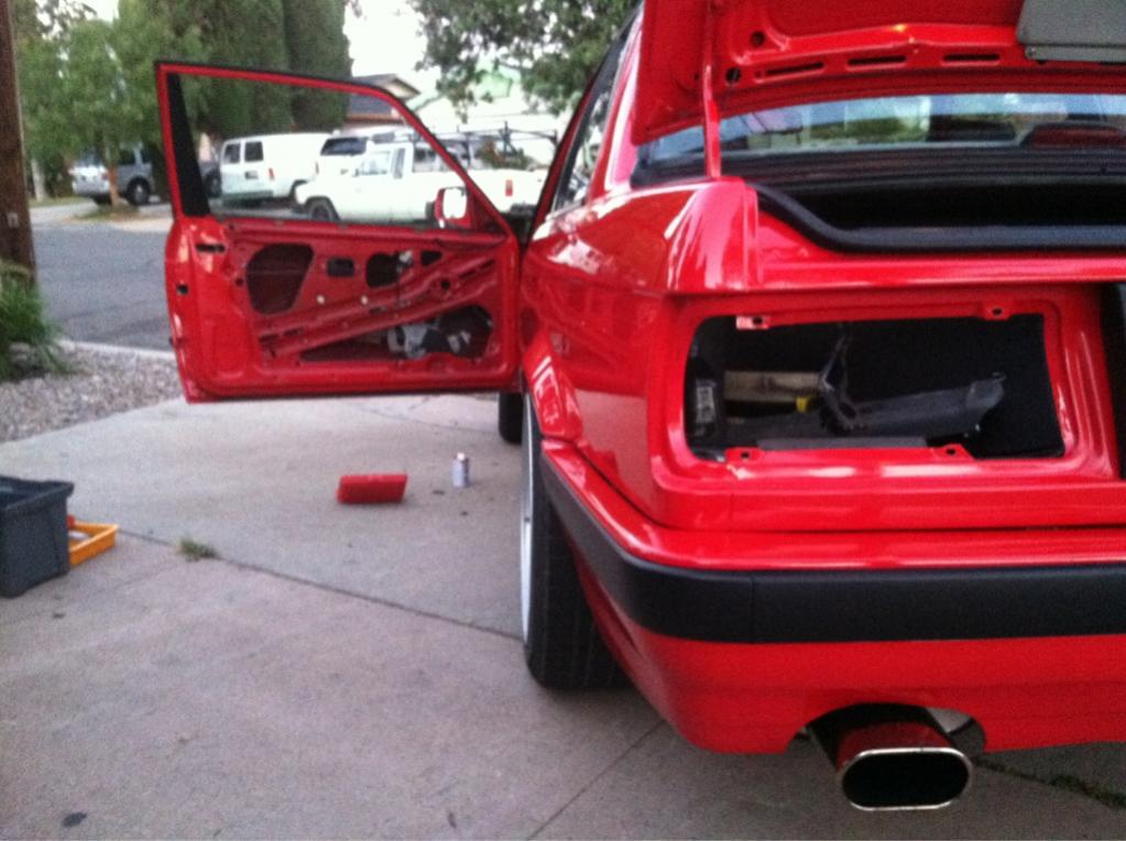

            Is it possible to do a repair on a new(er) paint job with out, let's say, respraying a whole fender or quarter panel and make it look the same?
            1990 325is Brillantrod
            1973 2002tii Verona
            • oliver.r
              • Mar 2012
              • 3839
              #126
              nope.
              it always looks terrible.
              • alexth1
                • Jun 2011
                • 79
                #127
ID:	7143364Click image for larger version
                The mid section of the quarter panel
                Was re-sprayed due to a minor fender bender.
                My paint job is about a year old.
                Painter did a great job :)
                1973 2002tii Verona
                • oliver.r
                  • Mar 2012
                  • 3839
                  #128
                  Looks good, most likely cleared the whole quarter panel and open blended at the sail panel
