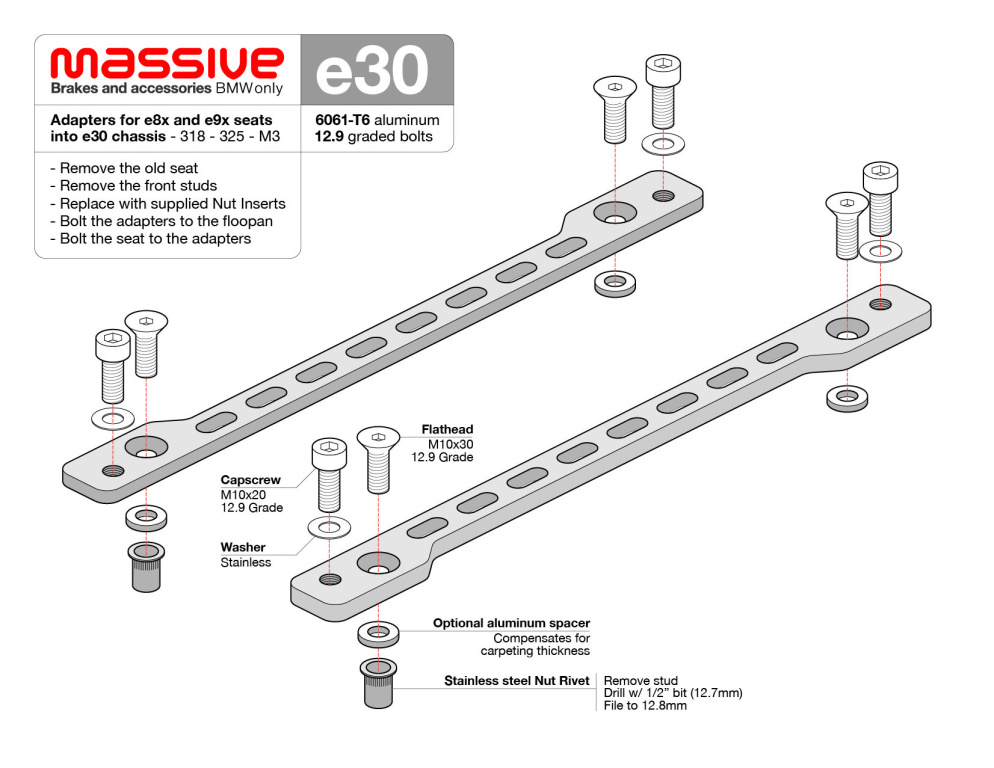

    Hi guys.
    It has been a long time since I sold my M3 and have barely been on R3V since then. But as I am producing e90 seats adapters for the e30 (I also make them for the e28 now) and wanted to present thwm.
    The adapters for e90 seats will be available in the coming month. Installation will be easy but NOT a 100% bolt-on as installation will require to get rid of the two front mounting studs. They can easily be hammered out, or pushed with a zip gun (my prefered method). And replaced by a stainless steel Inserts that will come supplied in the kit. Believe me, there is NO other way to fit adapters for e90 seats. And you can trust the designer of the original e30 Recaro adapters.

    How thick are the brackets?
      8mm

        I have some follow up questions:
        1. Do the seats happen to rest on the bolts that are securing the adapters to the chassis? If so, how much seat get raised in total, including the 1/4" bracket?
        2. If you move the seat all the way forward / back, how far are you from the pedals / steering wheel? Please include your height.
        3. Any pictures of the adapters installed with or without seats?
        4. What material and color / finish will the final product be in?
        Thank you for creating and providing a solution! I have made my own adapters that fit E92 and F32 and figure these would be good discussion points.

          I can see that you have tackled yourself the design of the adapters and maybe have hit a few walls. 25 years experience making e30 parts gave me the solutions to all your questions.

            I wouldn't necessarily say hit a wall, as I have been running my adapters for a couple of years now. Some minor things I would change for myself.
            Your intro price is great.
            The kit doesn't raise the seats more than the thickness of the adapters. Or if you elect to sue the 3mm thick alu spacers to fit between the floorpan and the adapters to make up with the thickness of the carpet, then that'S all it raises the seat.

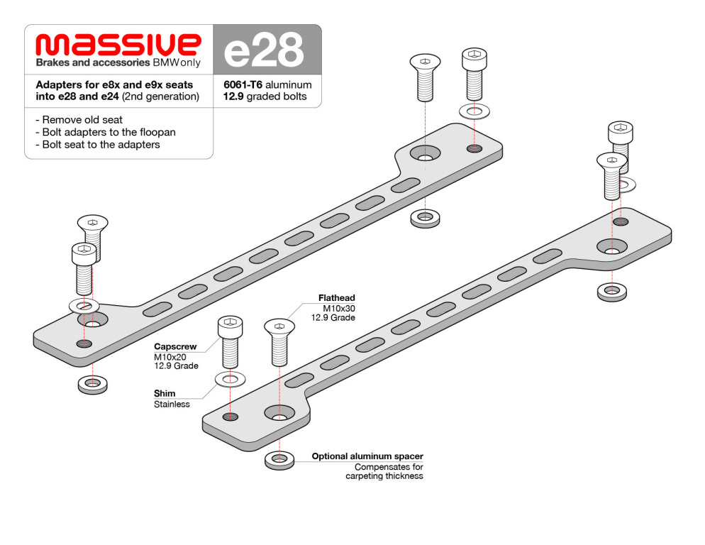

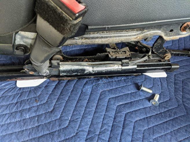

                        I wish to mention that the e90 adapters fit ELECTRIC seats as well as MANUAL seats. While both types of seats share the same mounting dimensions, the bottom face of the electric sliders is flat, while one of the manual sliders' bottom face has an 8.5mm deep ridge. And the sliders sit flat on the adapters. There's no spacer in between. This made the design a bit more involved but it works great. Using 8mm thick material, and therefore the seats are only raised 8mm off the floor pan. Nontheless, I will still include 4.5mm alu spacers if you want to insert them between floorpan and adapters if your carpet is thick.

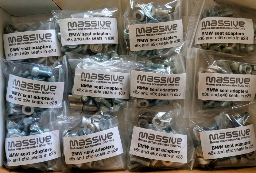

                            All fasteners are bagged. ETA is 14 days at most.
                            Click image for larger version  Name:	PXL_20231109_192623486.PORTRAIT~2.jpg Views:	18 Size:	282.0 KB ID:	10108096

                              e28 adapters also available
                              Click image for larger version  Name:	e28_e90_seat adapters_manual.jpg Views:	0 Size:	146.3 KB ID:	10108533
