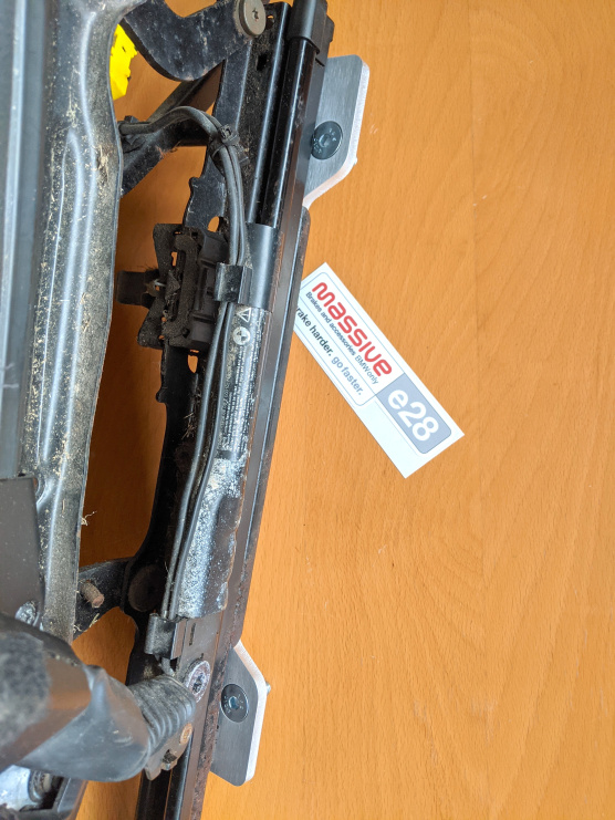

      HI everyone
      Third attempt worked as a charm. I had to refuse two bacthes of laser cut parts. The cutting was not smooth and the adapters had warped from the heat.
      Shipping on Thursday morning. I sincerely apologize for the delays.
      On the left - e80 and e90 adapters for e30 chassis - Sold out
      Center - e80 and e90 adapters for e28 chassis - Two sets available
      Right - e36 and e46 adapters for e28 chassis - Two sets available​

        All kits have shipped this morning. e30 and e28.
        I apologize for the delays. I had to refuse two productions that were laser cut with very poor quality. I went to another supplier.
        e28 kit pictured. e30 kits were already boxed and shipped.
        Will forward tracking numbers this afternoon

                I received them earlier this week, but have not had a chance to open them yet. I hope to possibly install this weekend, depending on how difficult it is to remove the front studs. Speaking of which...
                Originally posted by Massive Lee
                Installation will be easy but NOT a 100% bolt-on as installation will require to get rid of the two front mounting studs. They can easily be hammered out, or pushed with a zip gun (my prefered method). ​
                I don't have a zip gun, so I will be hammering them out. I did apply POR-15 all over the floor boards so I hope that does make it more difficult.
                • Massive Lee
                  • Sep 2006
                  • 6785
                  A third solution is to cut the portruding stud with a grinder and cutting disc, Cut it flat to the pan. Then punch the center of the cut stub to mark where to drill, and drill out in two steps. Small bit then larger bit,
                  Apply POR15, then fit the Nut Insert with a Nutsert tool.
                  or without the specialized tool
                  massivebrakes.com
