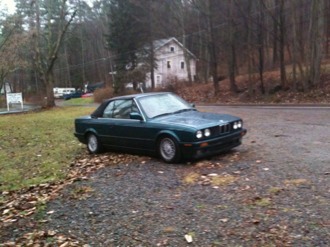

                    Just got done putting mine in. Only have one shitty pic for you guys.
                    That was six threads left in the fronts and just bottom adjuster in the rears. No spring pads anywhere. Installation was pretty straight forward. Getting the stock springs out was the hardest part for me as I had some shady ways of compressing the spring. Also the collars that hold the stock struts in were SUPER rusty and needed a little heating to be broken free with a pipe wrench.
                    Didn't drive it much yet but I dont rub anywhere and its a bit stiffer than stock. Stays ALOT flatter in turns.
                      Very nice Dennis! I had the same problem with my collars too. But with enough an persistence, it sure as he'll was coming off.
                      I rub if the front half of the car is on an incline and I'm near or at full lock. (It's happened more than you think.)
