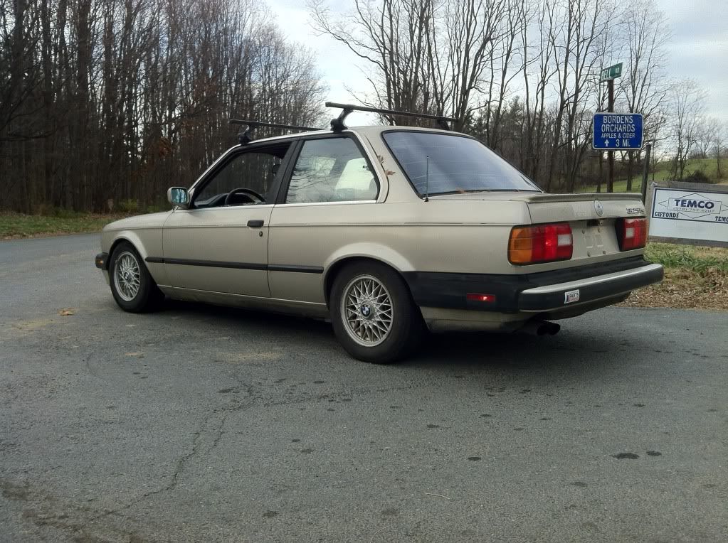

                  I left all of the spring seats and stuff in, pretty sure she's all the way down, though some of your whips look a lot lower. Im pretty pumped with the look and the ride! When i get some 15"s on it'll look much better, but this is how it sits now:
