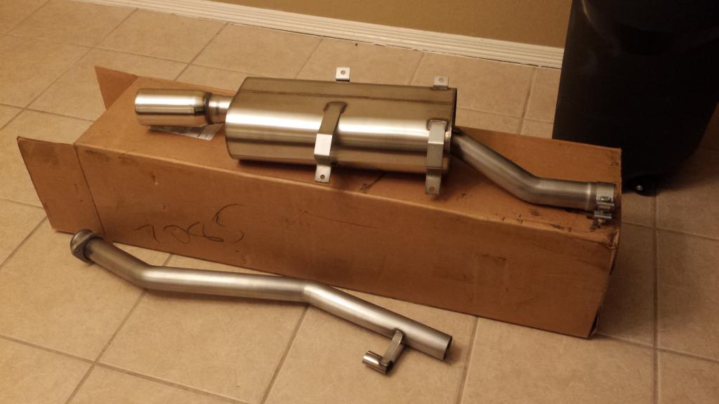

          Here is the exhaust out of the box.
            Should there be a compression gasket in this joint between the cat-back system and the front half of the exhaust system?
            I can't find any part numbers or reference to one in part diagrams on RealOEM, and I don't see any generic parts at the auto shop store. I'm new to exhaust, and feeling pretty lost here.
            91 318is Members' Rides Thread
              Figured it out sort of. Yes, there should be a donut gasket there. I don't know what size it needs to be. I grabbed the only one that looked like it would work from a local muffler shop. Should be able to try it out this evening. If anyone knows the exact dimensions I need, I'd love to know.

                There isn't a gasket in there as far as I recall. Just tighten the bolts, because of the way the front slips into the rear it creates a good seal as the flow is the right way, hope that makes sense..
                  No gasket on mine either. Works fine, no leaks.

                      Interesting. I had e-mailed Scott and he said that there's a donut gasket needed there, but they don't include one because everyone uses the one that's already on the original system. Are you guys bolting up to the stock system? Maybe you're reusing the donut gasket that was already on there without realizing it?
                      This one's slightly different from what I'm working with... the flange has a bevel so the donut has bevels on both sides. From what I can tell the gasket needed for our system is beveled on the muffler side and flat on the cat side. Or at least for my Magnaflow.
                      If there's really not a gasket needed here, then my Magnaflow cat section must have some holes in it. I've got hella leak.

                        Was wondering the same thing. I'm just gonna use my current one hopefully its in good shape
                          You may be right, I don't recall. I did have a replacement cat installed a couple of years ago and it may have had a good donut that I didn't notice. So take my above comment for what its worth (nothing).
                            Yep, bolted mine to the stock system and I think your right, there is a 'donut' on the stock system which is why I didn't need one. I forgot you were bolting up to a Magnaflow..
