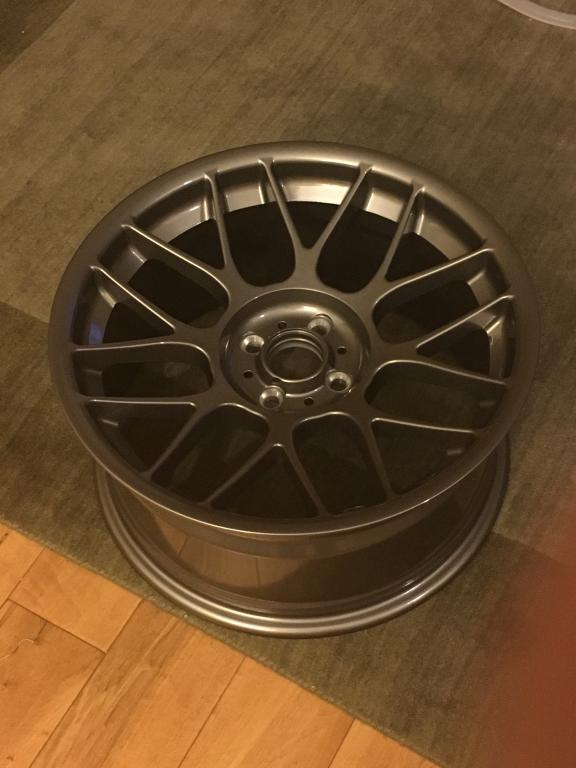

                                Why hello there. ;D
