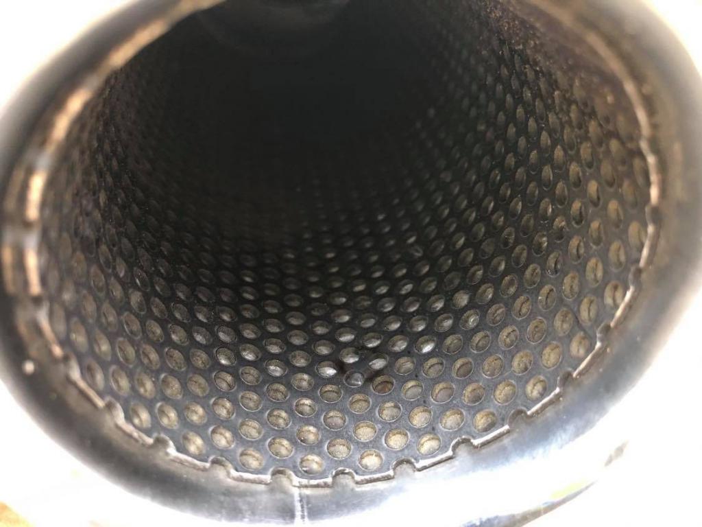

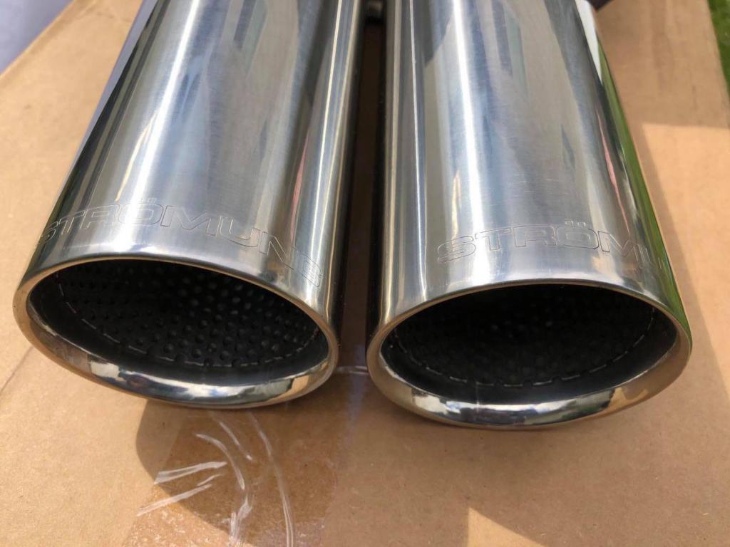

                              I finally received my Stromung exhaust from the previous group buy and it has the wrong tips. Does anyone know if there is a big sound difference between the resonated and non-resonated tips? I was thinking the exhaust tips would only be cosmetic and I was ready to live with that but I think the sound is going to be different too.

                                Was late to the order but made it in time. Just got delivered on Thursday and installed today. Took about 2 hours total, I just cut old out bolts pipe rubber mounts and all. The new one went in real easy. I bought all new rubber mounts and muffler mounts. Everything fit great, my tailpipe is 1/2 “ off center so I’ll have to bend the straps a bit to get it to center. BTW don’t need the bottom straps, I should have looked closer oh well.
                                One question, how tight are you tightening the spring/bolts to the cat? I’ve got about 3/4” threads showing, spring not bottomed out, pretty snug but I didn’t muscle them too hard
                                tried to add a couple pics but file size too big from my phones camera (I’m technically deficient)
